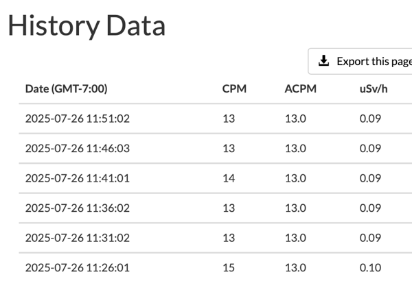

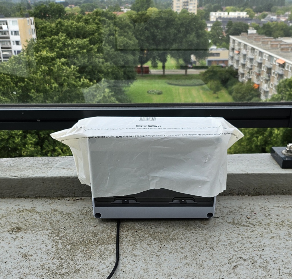

Posted - 07/26/2025 :  03:16:19  Show Profile  Reply with Quote
Upload works.
A Raspberry Pi is running with a soviet SI-22G tube :)
I also added a software correction of CPM values to a "standard" M4011 tube range, not to scare visitors with 70-80CPM values.
