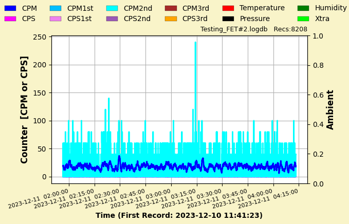

I just did a test using a "GMC-300Eplus" counter. This one does NOT offer the FET "correction". So I used GeigerLog to show what a FET correction of the "dynamic" (aka 3 sec) setting would look like, if it were activated.
In dark-blue is the counter's original CPM signal. In light-blue the FET distorted signal, derived from the counter's original CPS signal.
You see that FET makes the signal swing wildly, reaching a max of CPM=240, while the true CPM average is CPM=17.95.

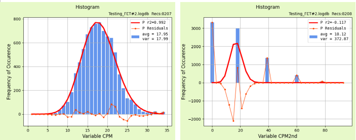

It is helpful to verify proper data with a Poisson test, shown in next pic.
On the left is the check of the original CPM - it doen't get much better than this. On the right is the check for the FET distorted data. The data are ruined and can't be corrected.
So, first thing to do is to set FET=60 to switch it off. If then you observe some spikes which you find unexpected, first check with Poisson. If this tells you those spikes are highly unlikely then you may have a hardware defect in the counter, which warrants further inspection!
