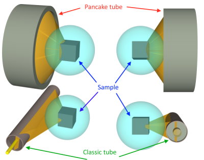

a larger tube gives better observation and allow measurements to be made more quickly in proportion of his size, but will not fundamentally change the result.
A pancake is better for sample test because it is very directional, but for an ambient measurement the traditional tube is better.
something else:
if you are comfortable with math you can look at the following article:
https://en.wikipedia.org/wiki/Solid_angle
It is important to know that for geometric reasons, the number of particles detected (intercepted by the tube) is a function of the square of the distance between the source and the tube (following the solid angle value formed by the active surface of the tube, and a center located at the source location).
This is largely why as soon as we remove the counter from the source, the detection decreases quickly.
There is also the fact that not all particles go very far.
Simulation bellow show a 10x10x10mm sample source with a SBM-20-1 and a LND7317 GM tube both at 10mm from the source.
we can see that in the case of the classic tube, the brown / orange cone is much narrower in the direction of its projection with respect to the thickness of the tube. in reality, it should even be a little narrower than that because of the tangent effects.
