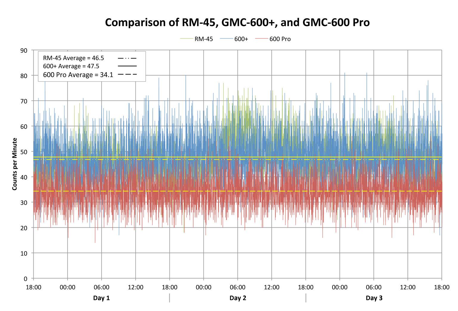

Soon after acquiring the GMC-600 Pro, I noticed that it seemed to be reading anomalously low. Just to check, I logged all three detectors continuously for three days. I placed all three detectors side-by-side on a table with the LND7317 windows facing up and nothing (except the table) for several feet in any direction from the detectors. Over the three day period, the GMC-600+ recorded an average of 47.2 CPM, the RM-45 recorded an average of 48.2 CPM, while the GMC-600 Pro recorded and average of 34.0 CPM.
In other words, over the three-day period, the GMC-600+ and the RM-45 recorded averages within 2.3% of each other, while the new GMC-600 Pro recorded approximately 28% less (it recorded a three-day average that was only 72% of the other two detectors).

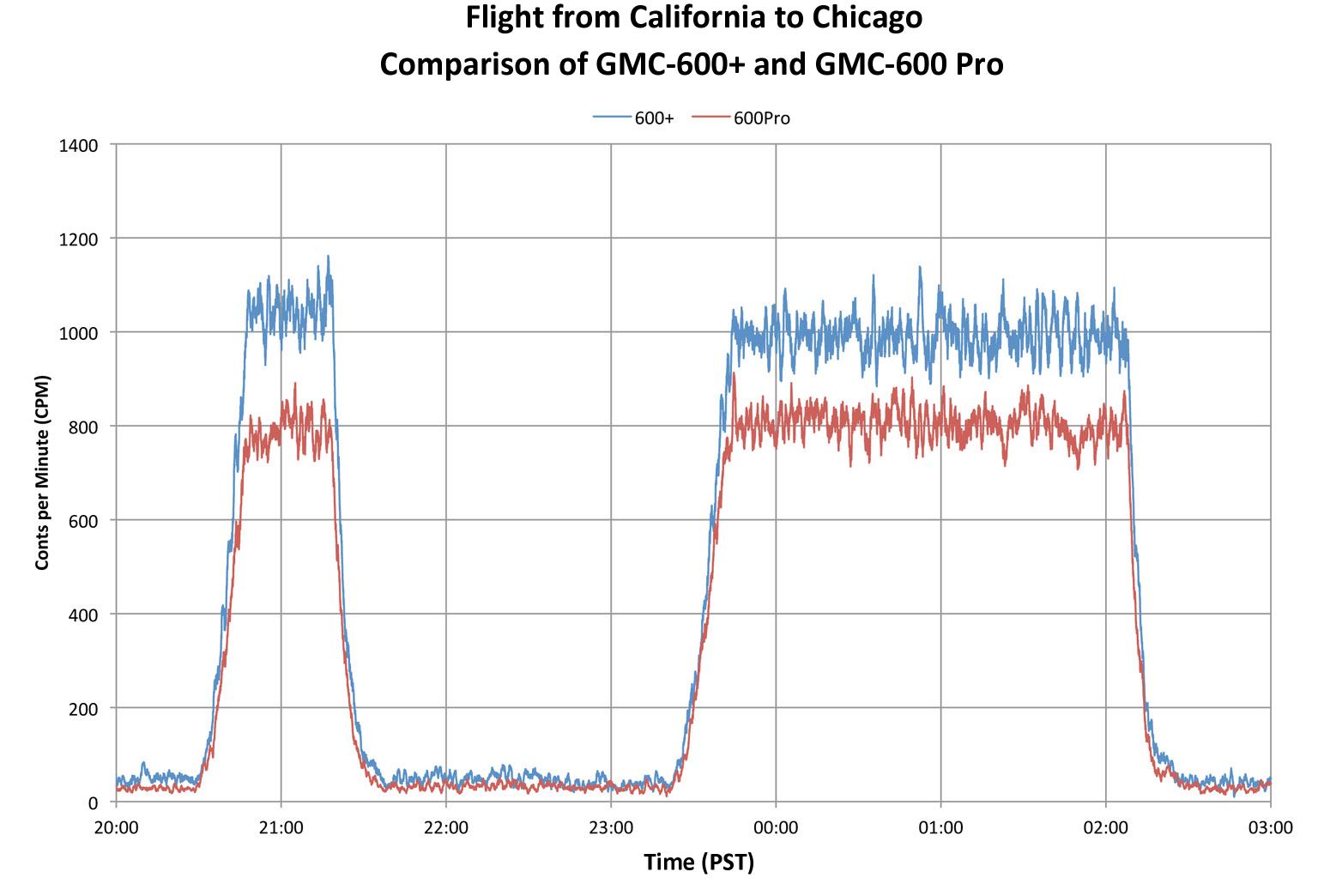

Soon after, I took the GMC-600+ and the GMC-600 Pro on a commercial aircraft flight from California to Chicago and back. I placed both detectors side-by-side in my nylon-sided carry-on bag which I placed in the overhead storage. Both units had the LND7317 windows facing up and had nothing except one thickness of nylon (the top of the bag) over them. The one-hour running average (OHRA) readings from the GMC-600 Pro, both on the ground and at altitude and on both flights, were consistently only 70% to 74% of the OHRA readings from the GMC-600+.
While I don't have any calibration sources, I assume that since the readings from both the GMC-600+ and the RM-45 have historically been similar (within a few percent of each other), the new GMC-600 Pro is giving anomalously low readings.
Can this be corrected? Or do I need to return the GMC-600 Pro to GQ Electronics?

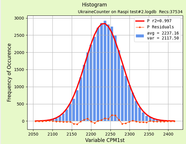

Third, the radioactive process can be described by a Poisson distribution. Human beings cannot tell whether any of the data scatter has a Poisson property. But software can tell. To my knowledge, the only one useable is my GeigerLog software. You find it here (it is open source): https://sourceforge.net/projects/geigerlog/
Load your data, then click "Poiss" to run a Poisson test. Data are ok when you get such a result, no matter how weird the data may look like;
And lastly, nice flight data! I'am collecting such stuff for hosting on my GeigerLog site. When you are ok with, please post the raw data!
