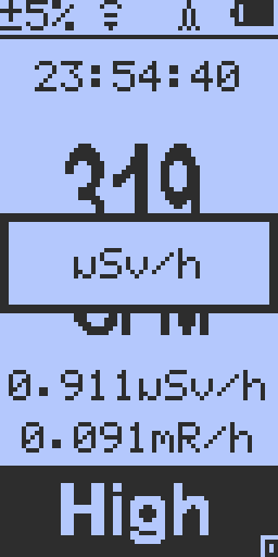

Originally posted by Searinox
Fix for crash in text mode over 10 uSv/h also confirmed! Great release.
Strange, mine crashes going over 0.999uSv/h.
This is just before the crash.
unit-change is up because my thumb slipped while taking the screenshot
This is the same thing in Text Mode.
Both crashes occurred by slowly decreasing the distance to an 6" Uranium glass candy dish. This dish could be pretty hot it's old and glows very bright under UVA, although I hear that has nothing to do with the amount of U in it.
It takes the 600+ a minute or two for the count to go back to the background reading after being close (5-6") to the dish, don't think I understand exactly why?
EDIT: I need to test this more carefully!
A 6" dish isn't really what one could call a point source, so trying to slowly ramp up the CPM may be impossible without saturating the tube.

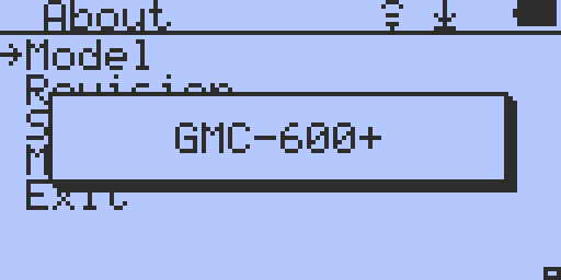

Hi Oldtron, which revision of 600+ do you have? It takes at least 1 minute to get a good reading unless you have the Fast Estimate feature it will estimate the CPM faster than 1 minute.
Oldtron
22 Posts
Posted - 03/16/2021 :  18:49:14  Show Profile  Reply with Quote
Sir EmfDev,
Revision 2.22

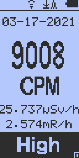

Repeated the experiment today: Same results…
Today’s Source: h**p://www.aladdin-us.com/product/R150# (Because I have an Aladdin Oil Lamp), I have 3 old broken mantles, so with only 1 mantle still in it’s cardboard box (0.38mm - 1/64” thick), right at 25.5cm - 10” in front of the GM tube opening.
As the count rolls up over 0.999µSv/h, the screen freezes, approximately 2 sec. then WDT (watchdog timer) resets microcontroller.
Fast Estimate was set to Dynamic.
Dead time set at 270µS, Enabled or Disabled still crashes.
Randy

Dead time was only a problem with very high CPM not the >9.999 uSv/h on Text screen. That was a separate bug. But I'm curious how that crash still happens as I am on 2.22 myself and it isn't happening anymore.

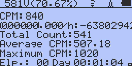

It required a second expresso this morning…

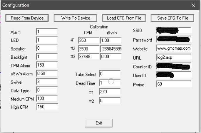

Look what I found; calibration data look a little strange?
After a Factory Reset, and reprogramming…
Up against the Aladdin Mantle box.
Noticed during attempted reprogramming:
Data Viewer - Setting - Configuration - Write to Device: Did not work
Data Viewer - Setting - Other - to reprogram device.
Then
Data Viewer - Setting - Configuration - Read/Write to Device: Did work
Strange, maybe, I don’t know, no big deal, may have been a brain cloud?
Anyway, I have no idea how or when the calibration data became corrupted.
If it wasn’t something weird, I would have to say it was a USB communication error during reading/writing operations with the Data Viewer/Logger software, or possibly a temperamental USB cable, but I have no clue...
A uranium atom is only three hydrogen diameters, but 238 times as massive.

Posted - 03/18/2021 :  00:22:29  Show Profile  Reply with Quote
Looks about accurate for what I get out of these myself(I have a non-plus 600 device but still it's calibrated and I wrapped the mantle up to hold against the detector). Also I only just noticed, 70%+ voltage? Man after my own heart! \m/ I didn't even know you could set calibration to negative uSv/h. What even is a negative radiation dose rate? Lol. XD

Posted - 03/18/2021 :  00:44:39  Show Profile  Reply with Quote
Originally posted by Oldtron
Relax, Problem Solved, maybe.
On data viewer, have you selected the right device? (GMC-600+)?
I'st looks like a fake register map or fake definition, can be a wrong device selected or a bug from either the app or the counter.
in any case it should not be possible to look that, so there is a bug.
Edited by - Damien68 on 03/18/2021 02:58:46
There’s a thread about that: Sticky: Auto Voltage Adjust - 500+, 600, 600+
https://www.gqelectronicsllc.com/forum/topic.asp?TOPIC_ID=7677
That’s Old-tron not Stupid-tron!
No, really… Unless someone else has another idea, I must assume the cable was at fault or the connector was bumped while a transfer was in progress. That poor cable has since been retired, just in case.

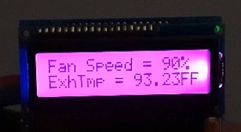

Take this MCU I built for a ventless heater fan, so… simple. Notice the two “F”’s. The last one was written when the temp was over 100. The first one was written when temp fell below 100(actually; the same one right, it’s just written to a different memory location). To get rid of the 2nd F you can just add a space “_“ behind the F to effectively erase the second F that was already in memory when the digit shift occurs. No wait you can’t do that because the communication protocol automatically removes any trailing spaces to speed up the display! Ok, let’s use an invisible character to erase the 2nd F. Nope, there isn’t one in the character set! Ok, I’m tired of messing with it so it’s going to stay that way!
Yes, there are a few ways to fix this but most just move the problem somewhere else like clearing the whole display and rewriting it till the flicker drives you insane. And this is just a two-line character LCD, a Graphic LCD is an order of magnitude more complex.
The ideal solution is to have the LCD custom made with your own firmware, so it behaves the way you want it to. Oh, but that drives the cost up till no one can afford it.
and now it work? or not?
Edited by - Damien68 on 03/19/2021 00:31:47
Oldtron
22 Posts
Posted - 03/19/2021 :  07:50:34  Show Profile  Reply with Quote
Damien68, Sorry if I wasn't clear: A factory reset cleaned up the corrupted calibration data, and the 600+ appears to be working perfectly!

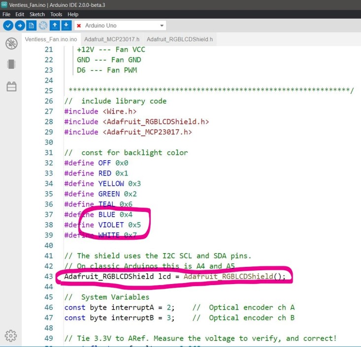

LCD: https://www.adafruit.com/product/716
No pink, that's supposed to be violet.
I change the backlight according to the particular function being executed so to observe the behaver of the program from across the basement. I can't read it from more than about 2 feet away.
