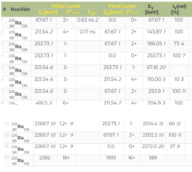

"I looked at details of the nuclear excitation levels of Ra226, and found that there are (at least) 117 levels, which result in gamma emission."
whoow i will make a video and will put this watch in a set of metal box definitely....

ullix Posted - 06/13/2022 : 01:05:37
One thing to note is that Bremsstrahlung is ALWAYS a gamma CONTINUUM, reaching from energy zero to max of electron energy. It thus cannot result in a single line, like 186 keV!
Unfortunately, there is no absolute intensity given. The 3% could have been a measure of the relative intensity of gamma lines, but this also is not supported by the data, as the 186keV line is only 73% of the 253keV line, so then the latter one would be more intense.
I think the authors of this article may have used very unfortunate wording or not understood the situation.
Anyway, there is quite a bit of gamma, of this isotope alone, and the many daughter nuclei may add to that.
