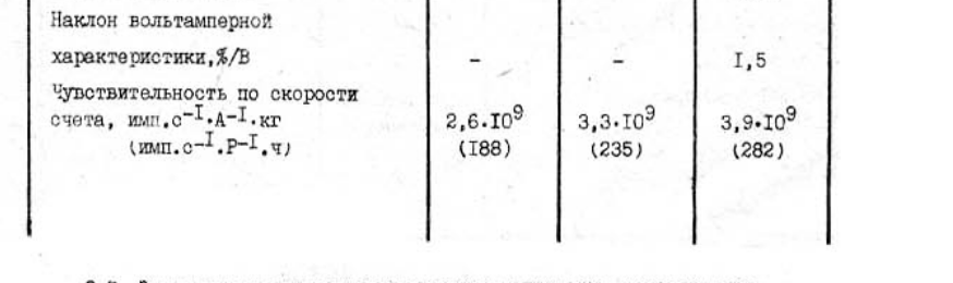

First off: if anyone speaks Russian, please take a go at the translation of this Russian data sheet of a SI-3BG Geiger tube: https://www.pocketmagic.net/tube-si-3bg-c%D0%B8-3%D0%B1%D0%B3-small-geiger-muller/ I am not fully convinced the presented translation is correct.
But, using it as given, I'll comment one by one the elements of the data sheet relevant to us:
Own Background: 0,2 Pulses/s
Working Dose Range: 300R/h (very high!)
Sensitivity to Gamma Radiation: 188 – 235 Pulses/s/R/h
I find it always frustrating seeing science oriented sites can't even get their presented formulas right: This does not make sense: Pulses/s/R/h. What they may have meant is Pulses/s/(R/h), or Pulses/s/R*h. If not, something else is badly wrong.
Assuming my correction, the Sensitivity converted to our units is then:
188 Pulses/s/(R/h) = (188 * 60 CPM / (10000 uSv /h) = 1.13 CPM/(uSv/h)
235 Pulses/s/(R/h) = (235 * 60 CPM / (10000 uSv /h) = 1.41 CPM/(uSv/h)
Average: 1.27 CPM/(uSv/h)

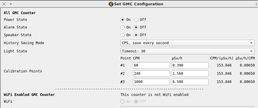

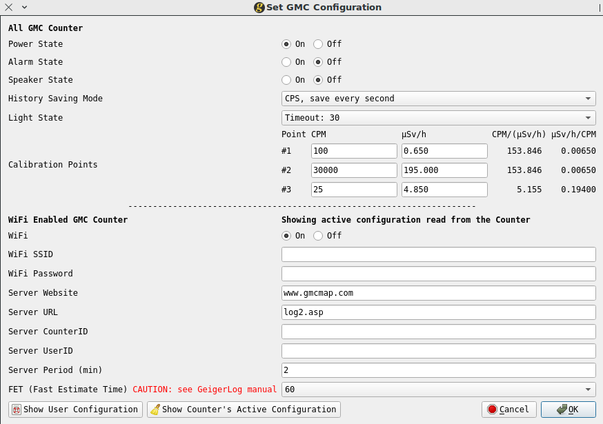

It is easy enough to look up the conversion factor currently used in your counter by yourself when you run GeigerLog.
For my 300E+ counter I get (1 tube, no WiFi; sorry for the large pics, but the numbers get blurry otherwise):
For my 500+ counter (2 tubes and WiFi) I get:
For the 300 you see 3 "Calibration Points", which all three resolve to Sensitivity=154. Why there are 3 points is a different story - you never need more than a single one!
For the 500 the first 2 of the points resolve to 154, which the counter applies to the first tube, the 3rd point resolves to 5.155 and is applied to the 2nd tube (thereby confirming that a single value is enough).
Mind you, these are not my numbers, but GQ's numbers as they were put by them into the firmware of the counter! And it is what the counter uses to calculate and display uSv/h results.
In GeigerLog you can modify these values directly in the dialog boxes shown. Once you have done the mods via the counter's menus, you will appreciate what GeigerLog offers ;-)!
GeigerLog never uses any of these numbers from the counter, but defines its own defaults. Which of course can be changed by the user.
By the lack of anything better, I also use 154 for the first tube. I use 2.08 for the 2nd tube, after lengthy discussions and experiments, some of which also told in the manual.
Confused enough? I have more ...
