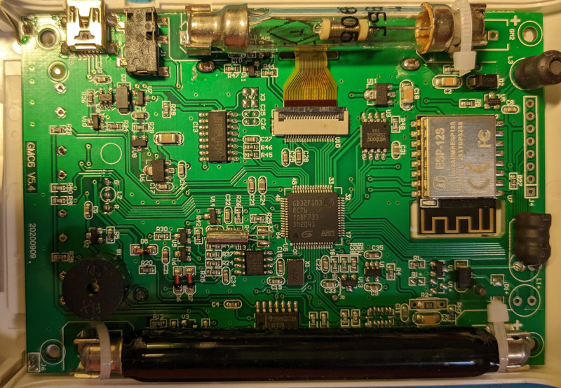

Here a picture of the PCB in case there are questions of the specific hardware version, etc:
Thank you!

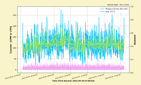

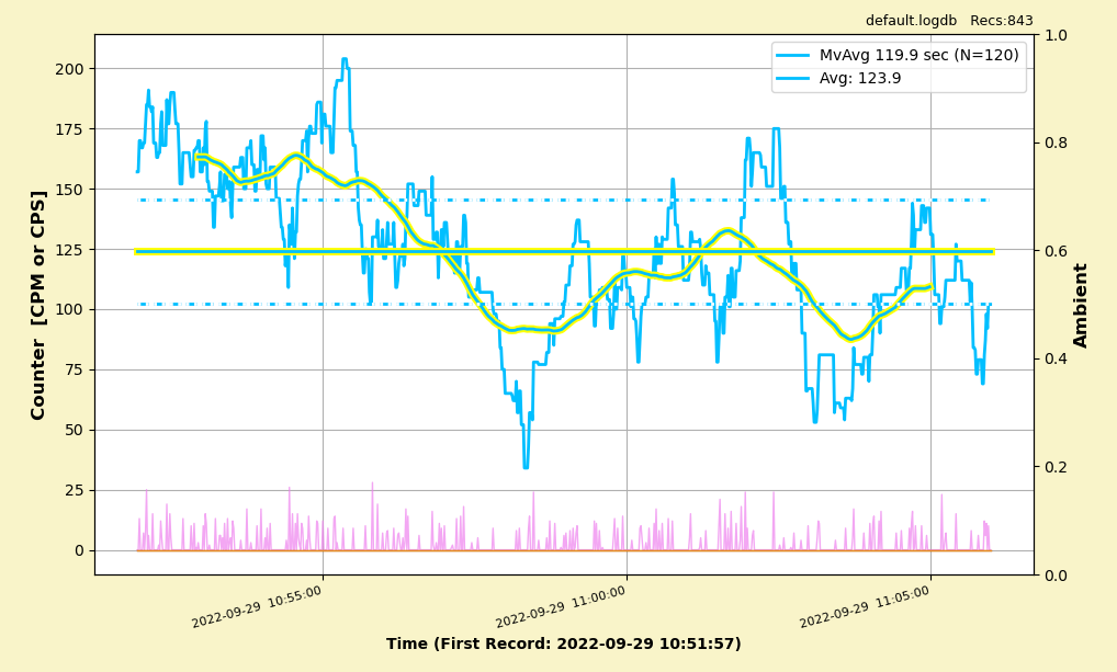

I used Geigerlog today to check the readings :
They seem very erratic despite the same location, same temperature and same light conditions (tested again with the device protected from light and not, and the both runs followed a similiar pattern and readings).
Thank you again,
Diego

Your wondering about the "erratic" data is very valid, and GeigerLog offers a few tools to give answers, see chapter "Quality Control of your Data" in the GeigerLog manual.
By far the most important tool is the Poisson Test. In GeigerLog push the "Poiss" button when your CPM data are shown, and try to understand what it tells you. It may be a little bit demanding at first.
I guess the stretch of data that you are showing is too short for a conclusive answer; you may need at least 10 times as many data points. So far it looks a bit strange, but may nevertheless be perfectly ok.

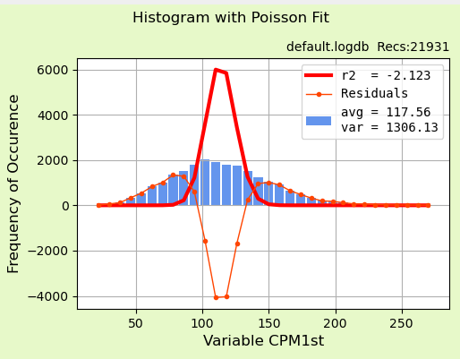

I took many hours sampling just background raditation and indeed there is no Poisson fit at all:
And here is the data:
So I think it is clear that the unit will need fixing, indeed when it was working I was getting consistently 15-30 CPMs.
Thank you for your help! have a great weekend.
