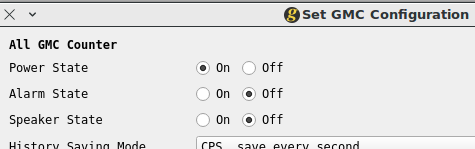

The option to separately change clicks on or off and to change alarm sound on or off exists since very old firmwares, if not from the very beginning. And no indication that this will change.
You can easily set it in GeigerLog:
