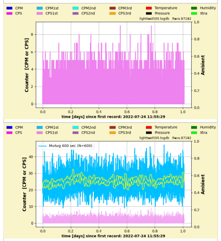

@Cristian: Just to underline what you are saying about monitoring, here are some of the routine graphs from GeigerLog. Both pics show exactly the same data:
The upper pic shows CPS over 24h. Hard to figure out what to do with it.
The bottom part shows CPM (blue) and CPS (violet). CPS is still rather useless, CPM is better, but has perhaps still too much detail. The yellow line is a CPM Moving Average over 10 min. This is more what is needed. It can be configured to your needs.
By the way: the little hump around 0.2 d is significant. It is invisible in CPS, barely visible in CPM, but clearly showing in the Moving Average. Rumors suggest a radioactive-alien-flyby, but in reality it indicates light sensitivity of the GMC-500+ tube in the afternoon sun!

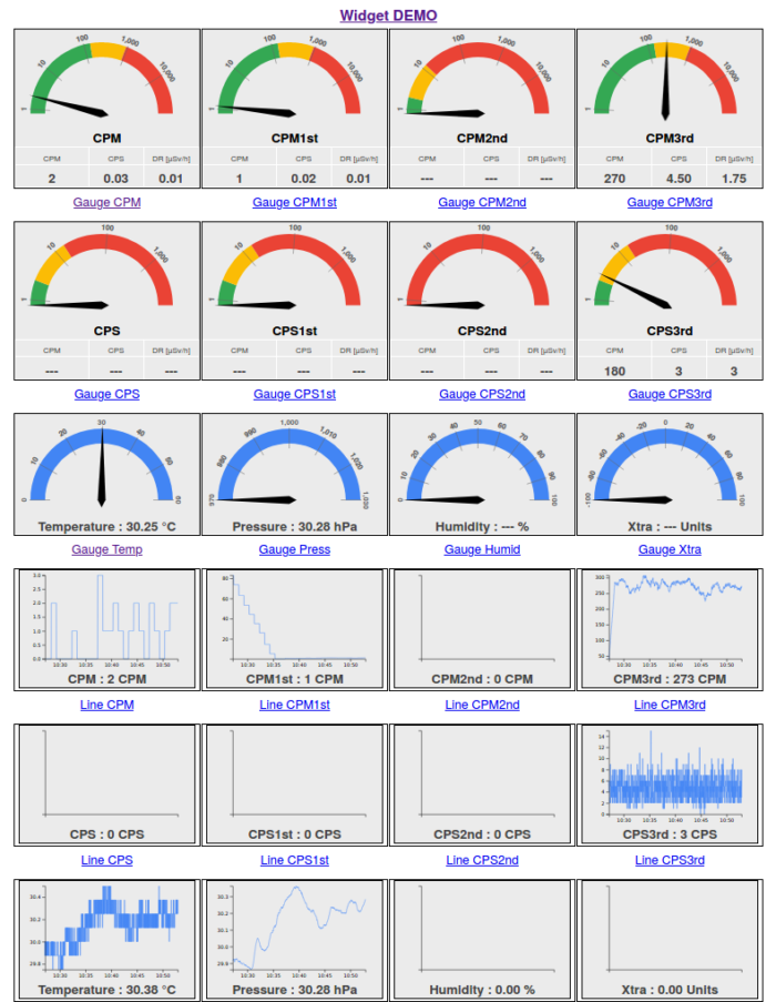

GeigerLog allows being monitored by a Smartphone. You can pick and choose e.g. from this array of widgets:

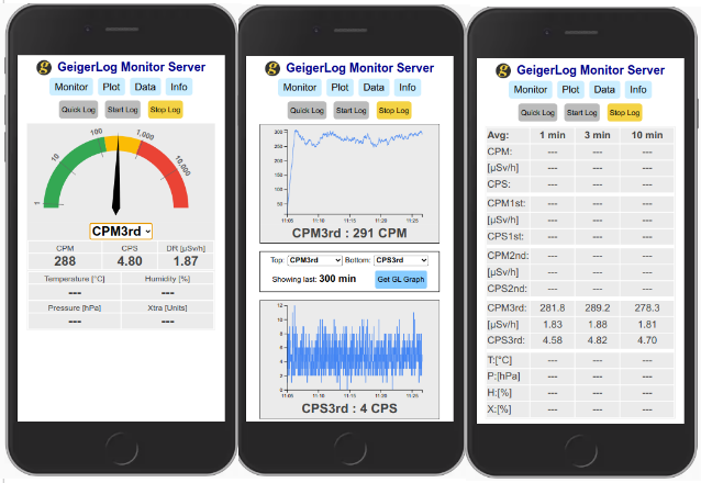

#2: You could take a Raspi, install GeigerLog, connect it to a 500+ counter, and connect the Raspi to your WiFi network. Then you can monitor GeigerLog from your Smartphone (if you open the proper port on your router, you can monitor from anywhere in the world):
More to come in the next GeigerLog 1.4 version.

Ullix, you're perfectly right, the moving average is the most meaningful of all. Such a graph, with customizable length, would be perfect for the on-board display.

If I am not mistaken then you can't sent data to the Home Assistant, but the Home Assistant has to request them? Which is done e.g. by integrating of one or more of the widgets shown above.
Here is an example for how a GeigerLog user integrated GeigerLog widgets into his Home Assistant based weather station:
Any of the widgets can be implemented, and more can be designed. All it needs for customization is some HTML and Javascript; take a look at the source code.
