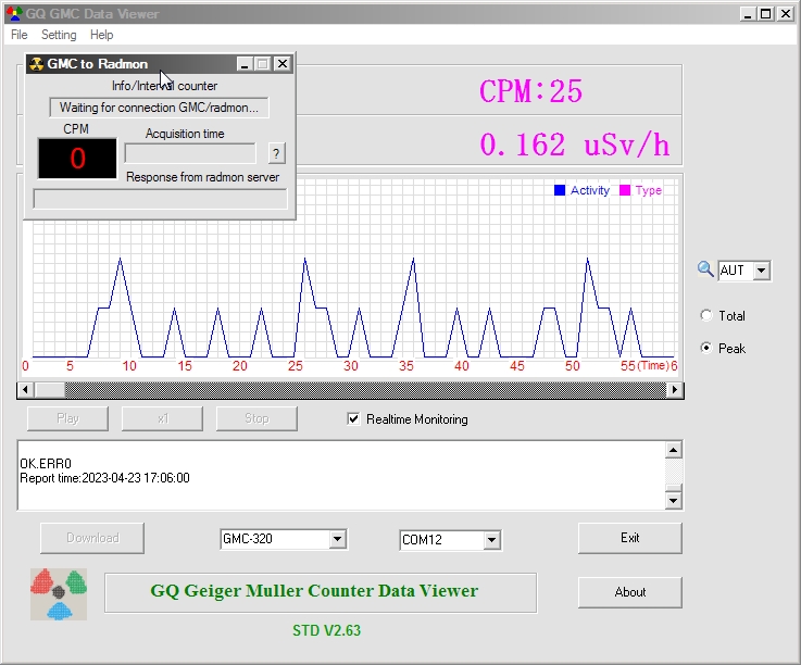

Posted - 04/23/2023 :  02:10:09  Show Profile  Reply with Quote
Originally posted by Marco de Chaligny
Very helpful idea! But can't connect. Can You solve this?
