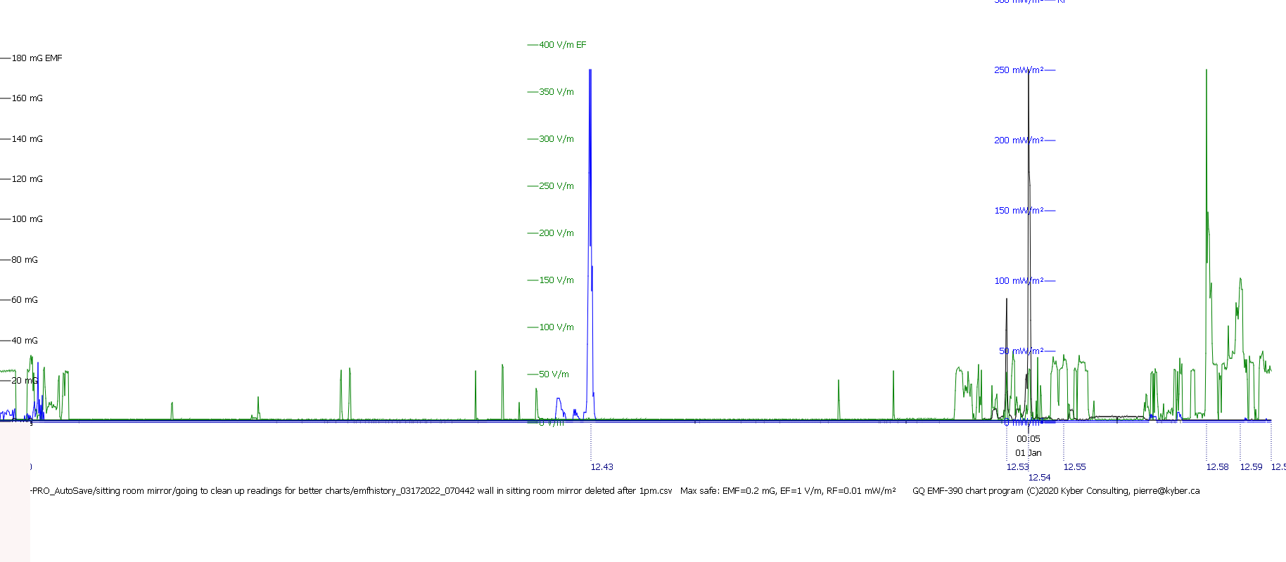

I am just wondering if anyone can tell me is there any logical explanation for this reading of RF of 250 mW/m2 taken from my living room one day?
During the same 30 minute period I also got a reading of 174 mG EMF and 373 V/m EF.

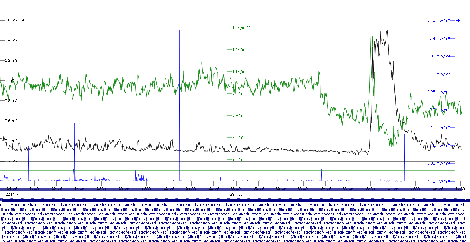

Heres a pic of the overall chart:

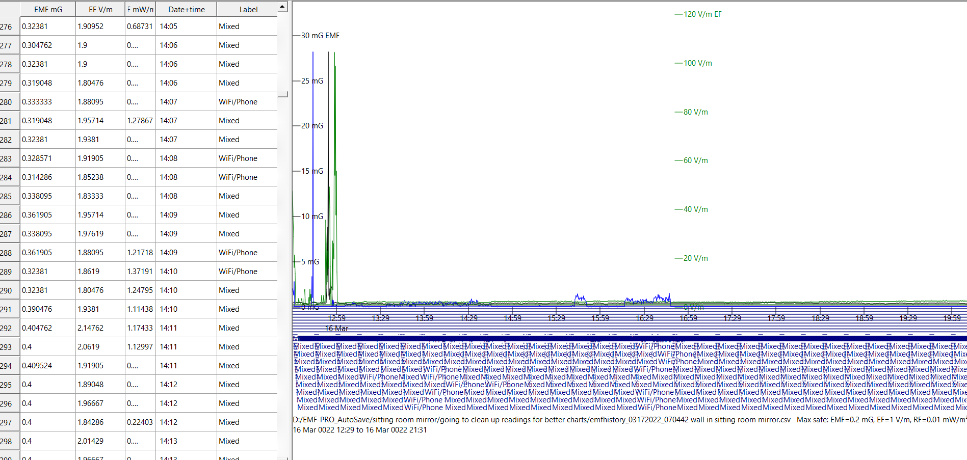

I then isolated just the first 30 minute period of where this occurred and got this chart:
Apart from the extremely high readings the EF keeps hitting 50 v/m maybe 20 times during this period.
The reader was just hanging on my wall, and I cant see any reason why this could be happening.

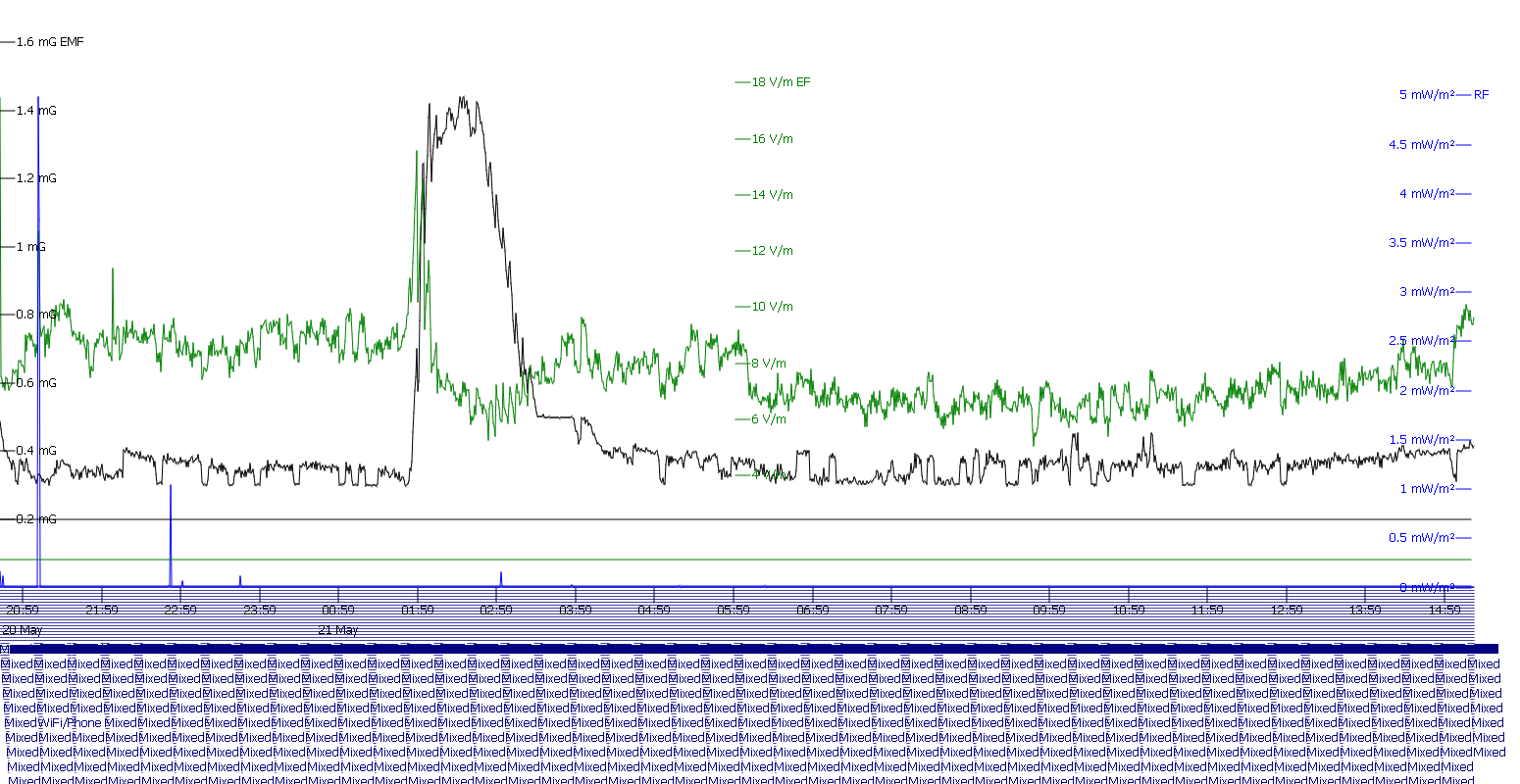

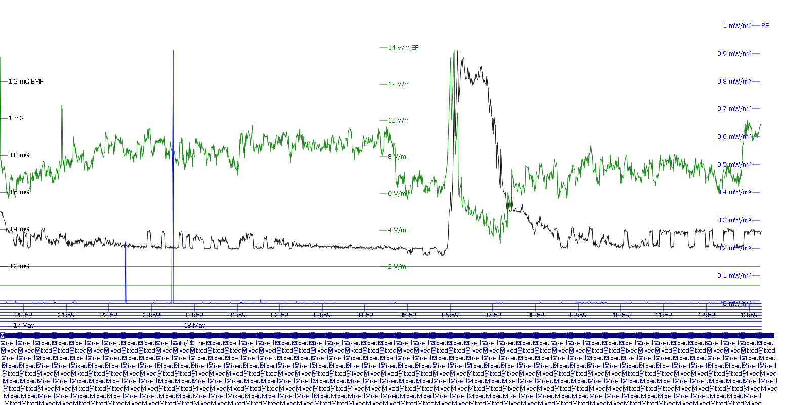

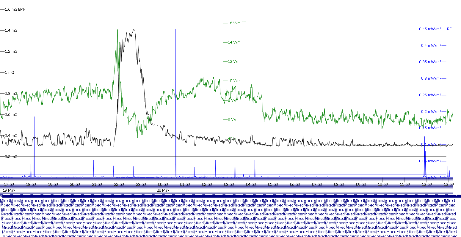

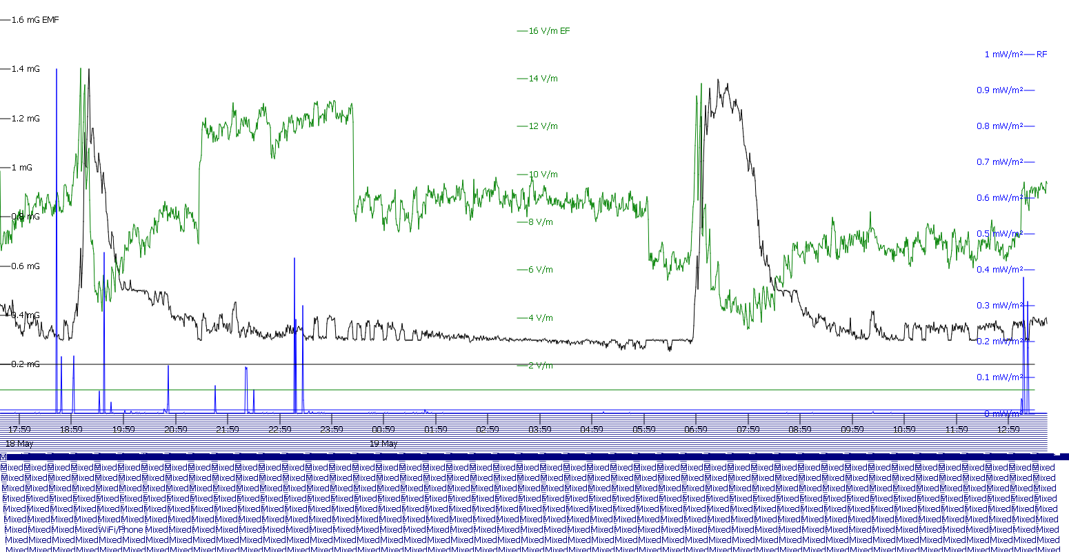

I also keep seeing graphs with a particular pattern emerging. Look at these following charts and how similar the spikes in EMF and EF are over these different days. The EF and EMF spike together and each time make a very similar looking pattern in each image.
In each of the images the EMF and EF shoot up together and then slowly reduce, make images that look so much like each other I cannot explain it.

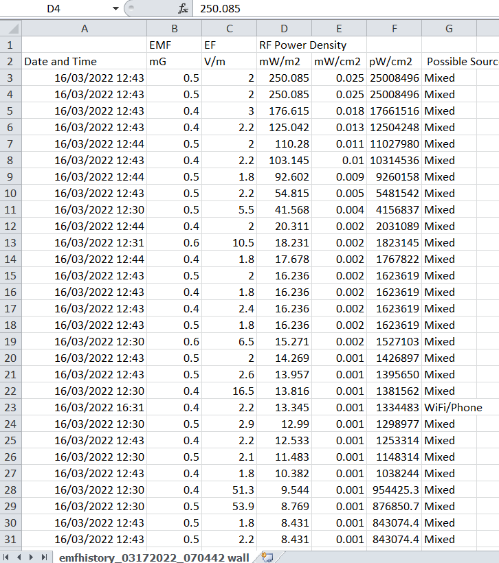

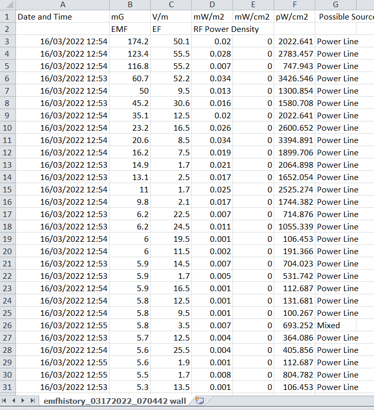

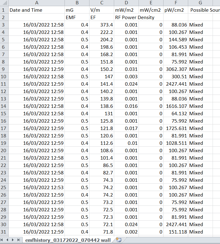

Hi Thanks for the reply,
heres screenshots of the data and i have sorted the readings for high to low.

For the EF, it may be caused by your electricity use as it can affect the EF of the whole house. For the RF, it may be due to cellphone / wifi or some of your electronics transmitting through RF. For the EMF, it's hard to see which device could have caused it. Maybe the wirings behind the wall that could have caused the EMF, but only when a certain device/equipment is turned on like your heater/microwave.

Posted - 06/01/2022 :  22:25:11  Show Profile  Reply with Quote
sometimes when there are problems with 4G the phones automatically switch to 2G mode. at this time the phone emits much louder.
in 4G the phone transmits with a maximum power of +21dBm (125 mW on its transmission antenna)
in 2G the phone transmits with a maximum power of +33dBm (2W on the Tx antenna)
the peaks that you have occasionally can come from there, if your phone switches to 2G mode it will be much louder (16 times louder), it's just a possibility.
250mW/m2 is roughly what we should be able to measure with a phone transmitting in 2G at its maximum power at around 80cm.

Posted - 08/27/2022 :  01:26:07  Show Profile  Reply with Quote
Hello!
Well, first to say, talking about the RF, the measurement of 250 mW/m2 is not high at all!
In this time, with the new RF equipment for 4G+ and 5G "mobile telephone" network, you can get much more high values, in street or in home. They are pulses!!
Also the WiFi are pulsing! Since some months (2 ) ago. You can check using the Spectrum Analyzer mode, in the 2.4Ghz band.
Confirming what I am telling you, in your graph, the RF part is in blue, so you can see that there are "pulses". Like radar!
Talking about the EF and EMF, I think the previous post answer is correct.
