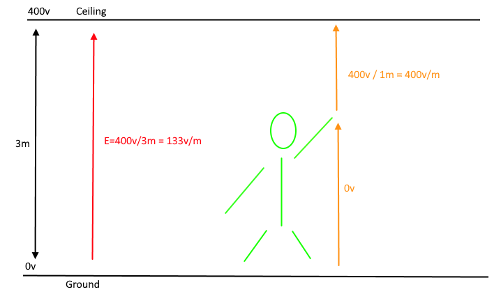

normally, in any case the EMF will measure the present and real static field, what happens is that it is your hand and in fact your whole body that will modify the static field.
what you need to know is that your body is a conductor of electricity, the electric field inside your body is therefore zero.
Below is a reference example, in this reference example there is a field between the floor and the ceiling of a room, a potential difference of 400v for a ceiling at 3m.
without your body, the field is therefore 400v/3m = 133v/m
now if you hold the EMF in your hand at 2 m from the ground, you will always have a potential difference of 400v but this time with a distance of only 1 m which will modify the field and we will then obtain a field of 400v / 1m = 400v/m.
it's just the simplified representation of an effect, in reality, it would be necessary to take into account the laws of diffusion and to integrate them in space, but roughly speaking, the measurement of the field changes because the field magnitude changes itself by the presence of your body.
