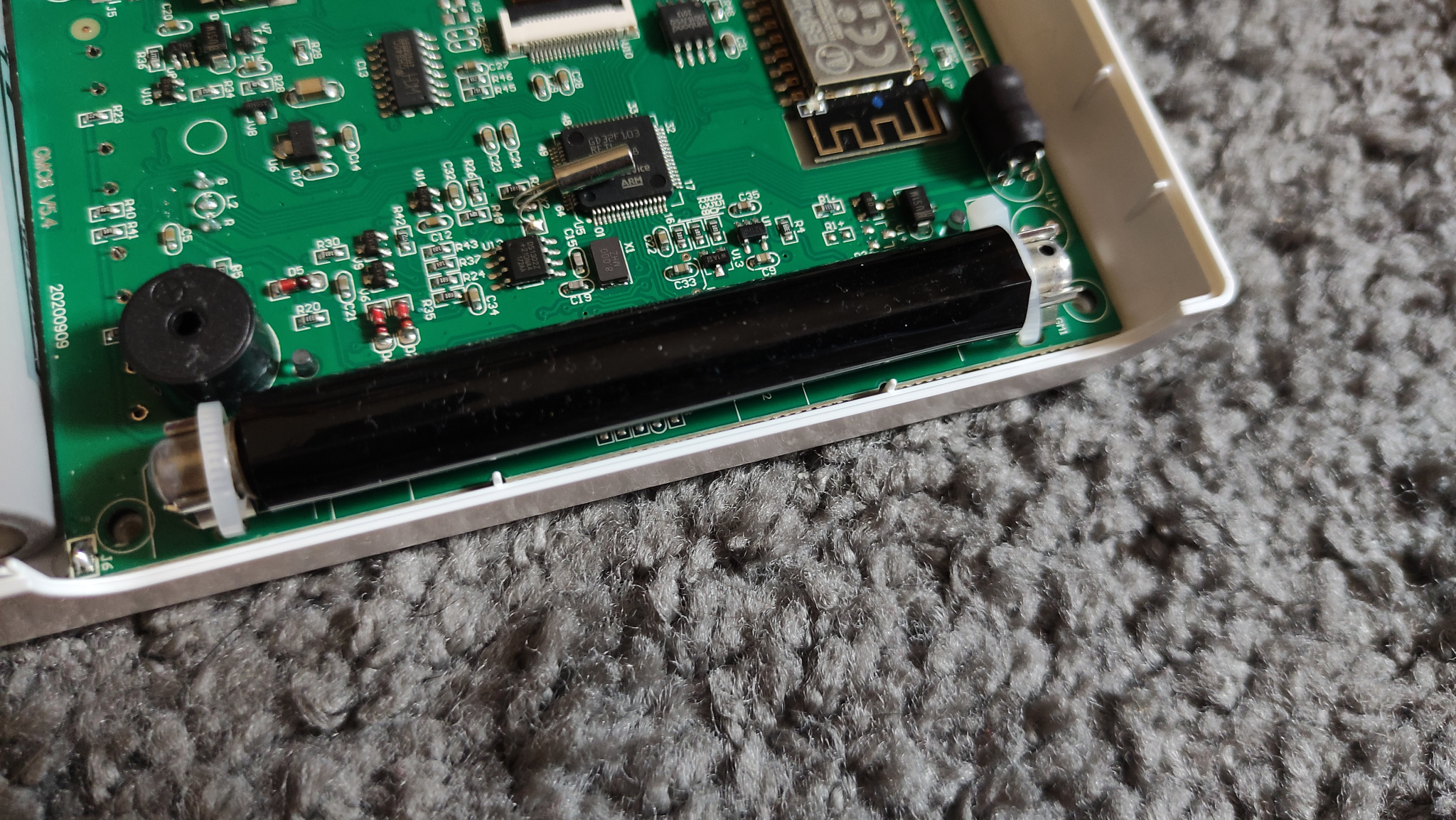

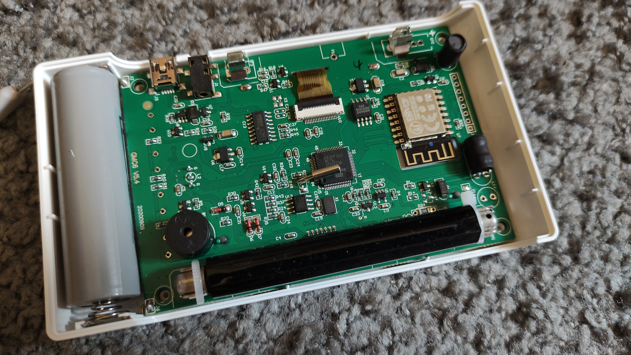

Today I got five GQ GMC-500 and each one already has a black foil inside (at first I thought it was paint). I think I have the latest series (software Re 2.29).

Maybe the black foil will finally bring a solution?
With 5 devices in your hand, there is a good chance for testing. Try with a strong white-LED flashlite, and shine along the tubes. In particulat try around the cathode end.

I have a very powerful UV flashlight so I will check each one.
I also have a 500+ with a GM type M4011 meter painted with black paint and it does not react to UV.
The newer GMC-500 are also devoid of other disadvantages of my older 500 and 500+

I believe that these versions will also not react to UV light, they are already very polished!
