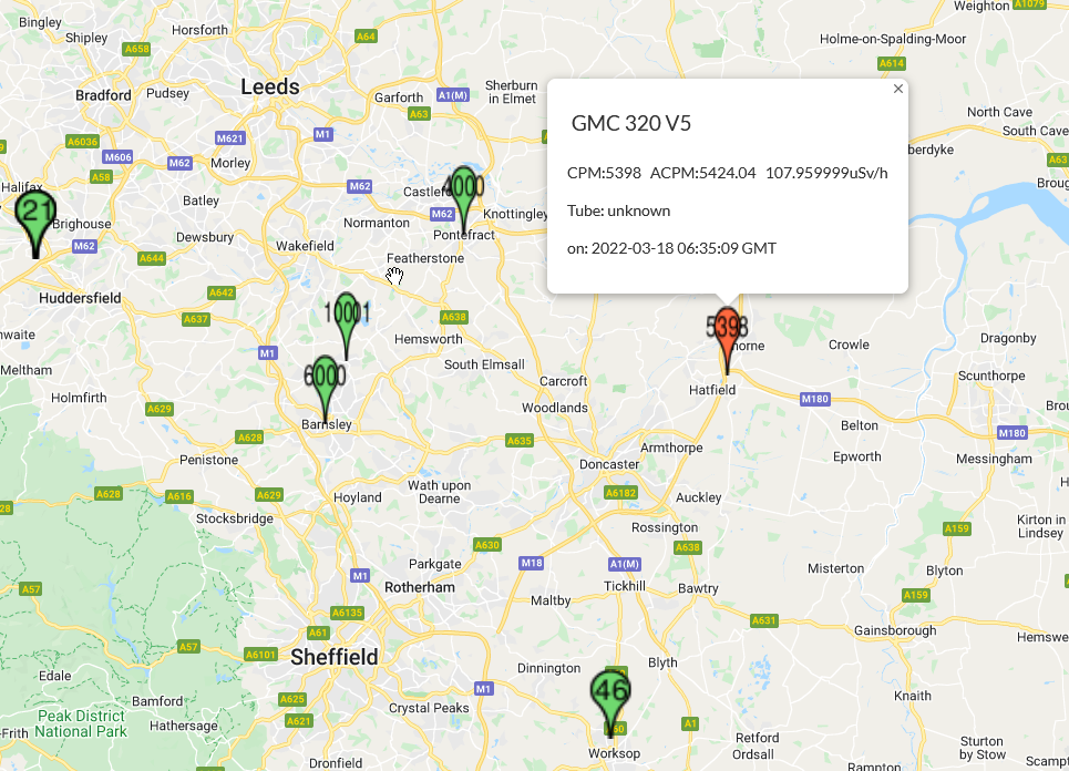

I need an explanation on why several readings are 400x what I see everywhere else. Just browsing so not familiar with values etc.
Any ideas?
I'd expect 1 counter to maybe spike once in a while, but there's 4 10-20 Miles apart.

The only way to get current data from the GMC map is to click on "time range", choose 24 hours, then refresh. The default includes old and sometimes bad data.

Aaah I see .. SO it's not at all "Real-Time".
Site needs some modernising then...
Posted - 03/28/2022 :  09:45:26  Show Profile  Reply with Quote
They are very very high. We will check this.
