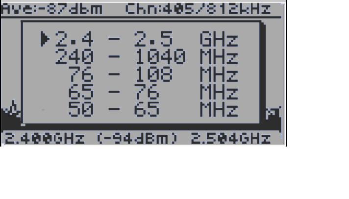

Hello :).
Please check the demo (simulation) table RF mode does not want to be displayed .
uploaded/Green Peace/20201118052328No Table Mode (RF).GIF
Can I decompose the RF signal into X, Y, Z axes ?
Please tell me the sequence of keystrokes to see the RF spectrum and RF browser for individual frequency
bands 4: 240 MHz – 1040 MHz and frequency
bands 3: 76 MHz – 108 MHz
0.0006 - 0.0128 mcW/cm2 = 0.006 - 0.128 mW/m2 = 48 mV/m - 220 mV/m :

Hi Green Peace, the RF does not have XYZ sensor. You must hold the down button to check other bands in RF spectrum.

Posted - 11/21/2020 :  06:45:33  Show Profile  Reply with Quote
.... You must hold the down button to check other bands in RF spectrum.
EmfDev thanks :)
Thank You for your response!
My action is this: I start the demo(simulation) by pressing the S4 button, then press the S1 button, select the RF Spectrum see the band 5: 2.4 GHz-2.5 GHz, press and hold the S3 key (at the bottom): nothing happens, the lane doesn't change :(
In the case of Table Mode, the same thing ...
You can download the demo(simulation) from here https://www.gqelectronicsllc.com/download/EMF-390_Demo.exe and watch it for yourself.

Posted - 11/23/2020 :  11:30:08  Show Profile  Reply with Quote
https://www.youtube.com/watch?v=AszUZQf6-Y4&ab_channel=JimMorrison
Here you can see an older version of EMF380. It is the same 240-1060 MHz and 2.4-2.5GHz but the bottom bands are different.
