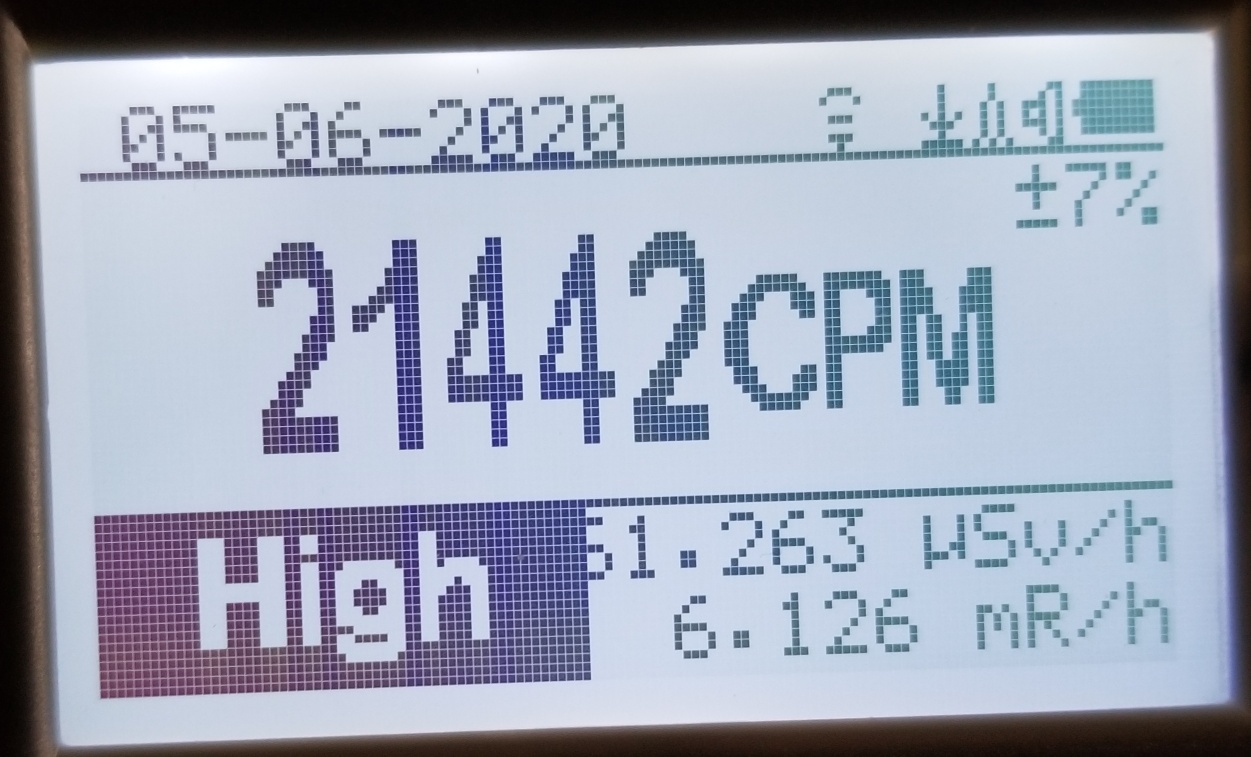

After playing with it for a few days I would like to list a few minor fixes for the next firmware release which will just polish the UI a bit:
- the bug of turning off the speaker when food testing is done (previously discussed in another post)
- In Timed Counting - the second menu item "1 MinuteCounting" needs a space between Minute and Counting
- it will be great if when Timed counting is complete and then Exit or Canceled is selected or you are at different screen like Large font and on completion to automatically switch and show the screen with the Timed Counting results. This way the user doesn't need to constantly check if the clock icon is still blinking and then scroll thru the screens in order to get to the results.
- The Normal, Medium and High msg on the Large Font screen needs to be a tad shorter (3-4 columns of pixels) to allow for the full display of the uSv value when it is 2/3 digit number before the decimal point (see the picture)
As you can see the first number for uSv is "chopped" and can be easily mistaken especially for digits 5 and 6 and also 3 and 8.

for the last point, rather than shortening the High / Med / Low label, for a +/-7% accurency value, we could truncate the value of uSv/h on 4 digits (ie display "51.26" rather than "51.263").
Edited by - Damien68 on 05/06/2020 23:28:46

Posted - 05/07/2020 :  05:23:30  Show Profile  Reply with Quote
Truncating the value to 4 digits when it becomes >9.999 or >99.99 i.e. 10.00 or 100.0 makes sense too. When you are dealing with high levels, over 100 uSv, rarely someone will need to see two significant digits after the decimal point and if this value is important to you, you can always change it to the main reading on Large Font.
I use the counter to check geological samples so I keep my display in CPM as I am most interested in the activity rather than the exposure but keeping an eye on the exposure rate is not a bad idea - that's what I like about the GMC-600 is the amount of information it displays at the same time.
Truncating will work if it is too much effort to make the alert window smaller but generally, as this is an instrument - I think actual numerical data should not be sacrificed in favor of an ambiguous 3-level alert msg that can be either abbreviated or iconized.

2322 Posts
Posted - 05/07/2020 :  10:33:44  Show Profile  Reply with Quote
Thank you for your suggestions, 1 and 2 are already in the next firmware update we are working on others.
