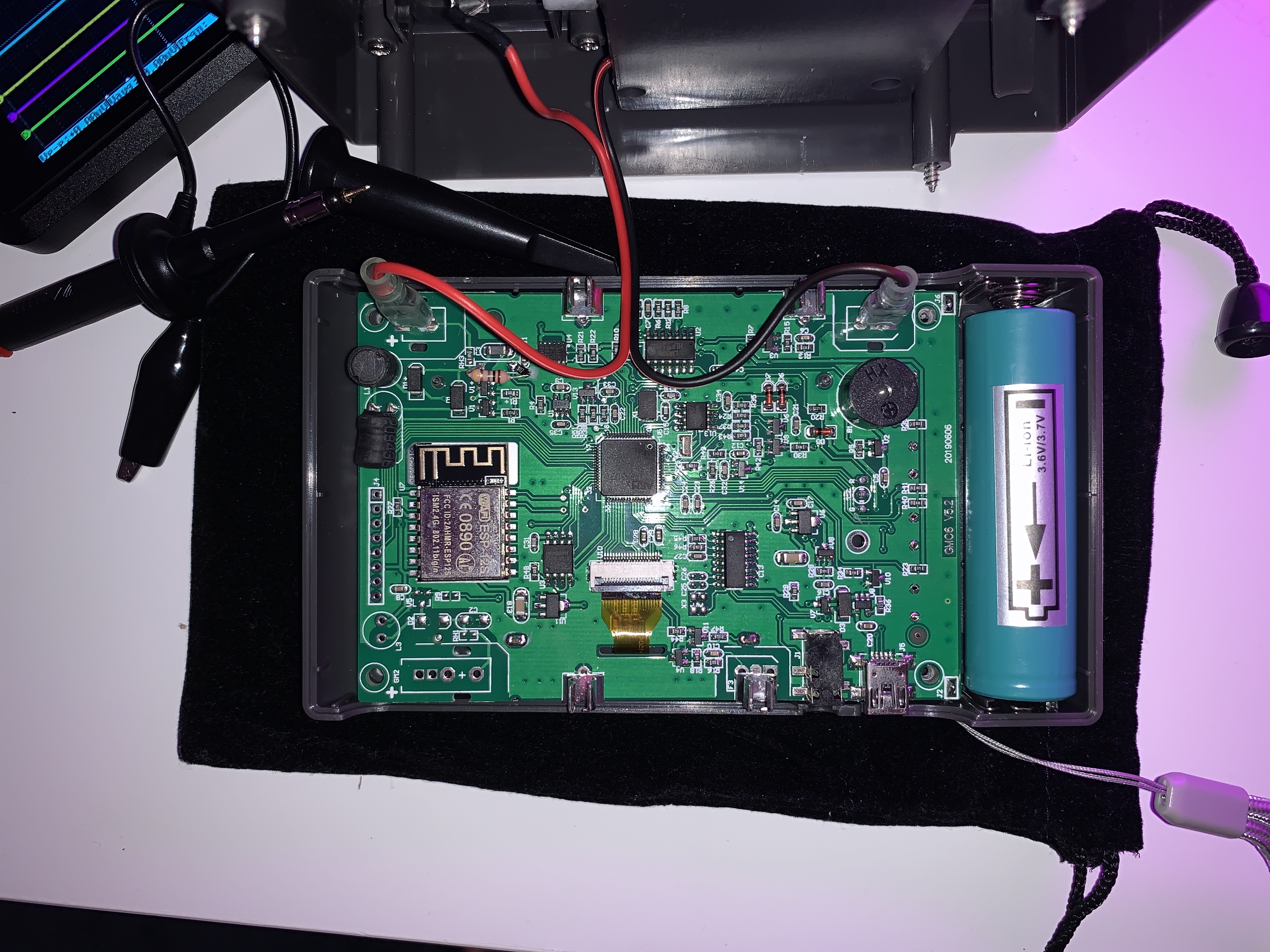

Posted - 12/26/2019 :  11:27:46  Show Profile  Reply with Quote
Yeah resistors. I had it open and at the top right portion of the board (the side with the WiFi module, with the tube leads at the top) there痴 a bodge with a through hole and surface mount resistor soldered together. This might be the problem, I値l investigate more tomorrow.(it痴 quite late where I am) I値l update in a few days. For now I知 perfectly fine with charging the battery outside the device.

Posted - 12/26/2019 :  11:40:58  Show Profile  Reply with Quote
Ohh if you can take a picture I can show it to our engineer.

Posted - 12/26/2019 :  12:00:50  Show Profile  Reply with Quote
Thank you for taking pictures!. Those resistors on the top left are ok. They're not part of the charging. I have to ask our engineer which ones need to be checked. But it might take few days since it's holidays. I'll let you know when they get back to me.

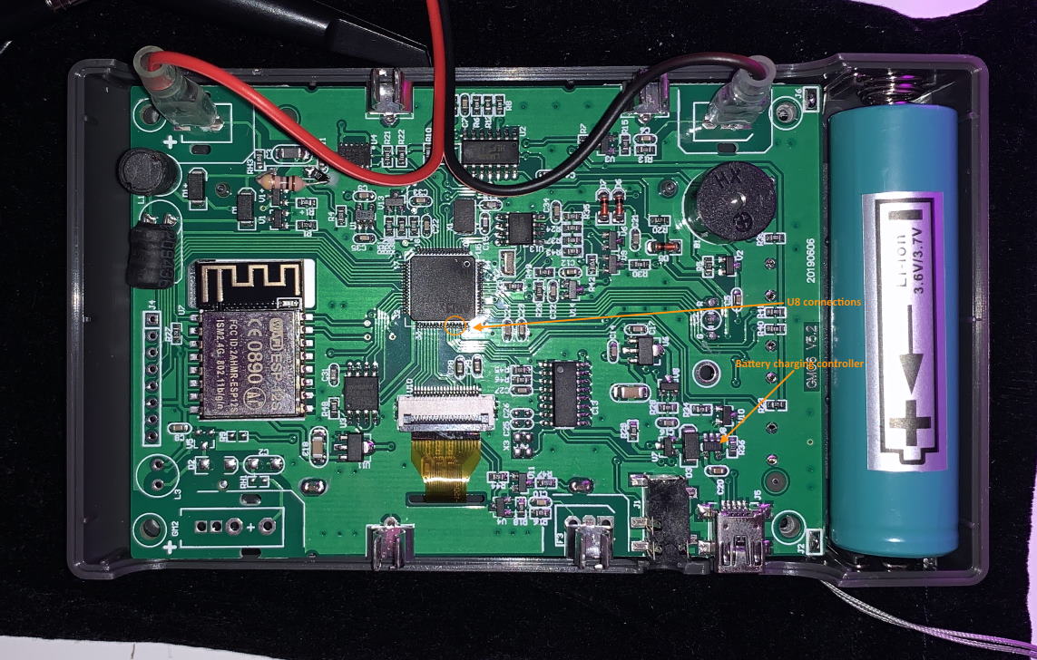

Posted - 12/28/2019 :  01:53:06  Show Profile  Reply with Quote
you can look around U8 which is the charge controller for the battery. and also look around its connections on the microcontroller
