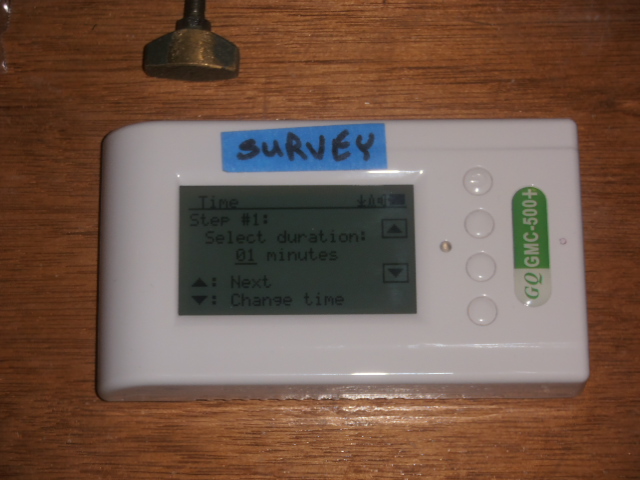

The Food/Sample Testing process is arrived at by repeated pressing of S1 (normally rotates you through Large Font, Graphic Mode and Text Mode). The Food/Sample Testing screen shows up after the Graphic Mode display and before you get back to Large Font. When you reach this screen you are at Step #1.
137274 bytes
The default measuring time is set to 5 minutes. The middle two buttons control the measuring time and moving to Step #2. The arrows on the right of the screen are across from the respective buttons (S3 and S2) and what they do is described at the bottom of the screen. You can only change the time longer with the down arrow button (S2). When it hits 24hrs you rotate back to one minute. There is no way to change the default from 5 minutes to say 1 minute, but GQ has changed the button timing and it's much easier to change the amount quickly. I'd like a shorter starting time (1 minute) as it's easy to get to 5 minutes if I want more. Once you're happy with the time you press the up arrow (S3) to go to Step #2.

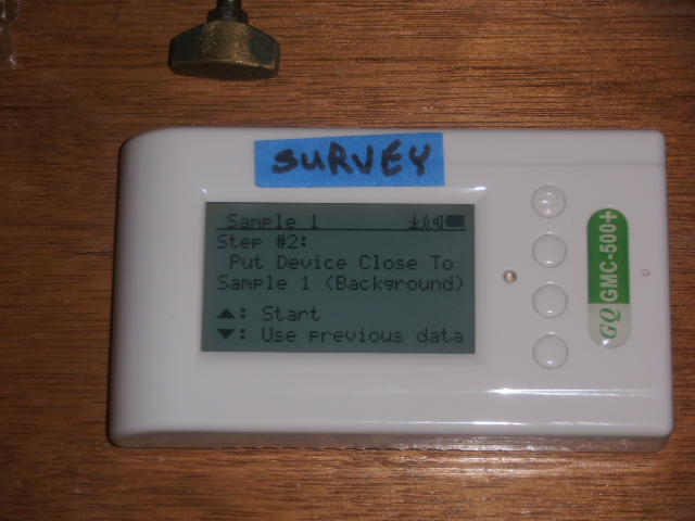

This step tells you to place the meter next to the Sample 1. If testing a sample against another sample don't forget to make sure you position the primary M4011 tube against the sample centered on the opening. With the power button upper right the M4011 tube is at the bottom of the meter. If you're doing the background measure and not comparing two samples against each other then simply set the meter somewhere convenient away from the sample. Then press the up arrow (S3) to start the measure. You have a 5 second delay before the measure starts as shown by time you set plus 5 seconds.

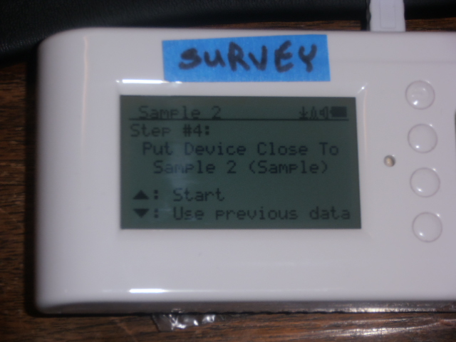

When that is complete you are asked to place next to Sample 2 (or the Sample if measuring against background). You can change the time with the down arrow (S2) but it is easier to leave them consistent. When close to the sample again press the up arrow (S3).

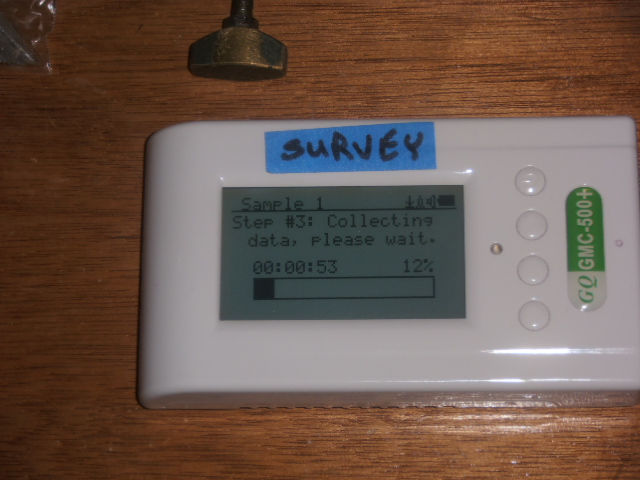

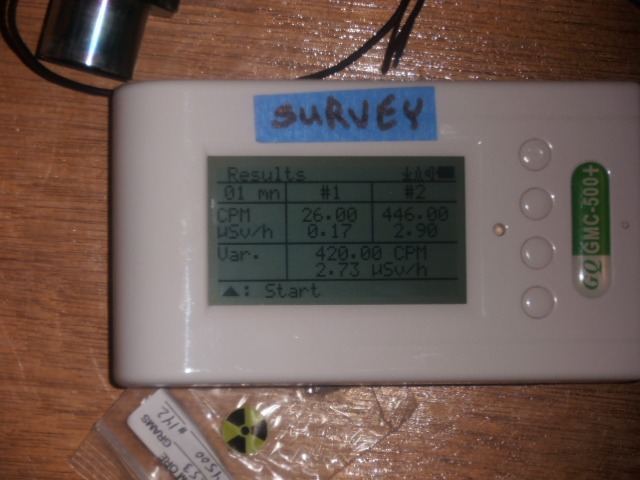

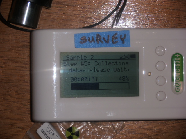

The meter goes into measure mode and when complete there is a display of the analysis. At the bottom is an up arrow to mean press S2 if you want to start again.
