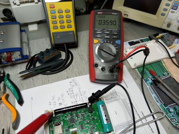

Hi, recently I bought a GQ GMC-500+ on Amazon Germany, and I am very pleased with this device. In the meantime, I got my inspiration from this forum, and I just finished your first DIY, it works great. By the kindness of the support team, we have completed the second of the DIY. I just got the firmware update, Re 2.12. I thought it was ok, but I've seen it here on the forum that someone else had posted the same type of device, with the firmware update, Re-2.13, in which the control voltage of the tube by showing the value in volts on the display. I've asked for the firmware update, Re-2.13, I get it, but it didn't change anything to me, it looks the same to the voltage in percent. I think I'm doing something wrong with the DIY or on the PCB. I have a request if you can help me out with some expert advice. I attach a few pictures of the device. Thank you very much.

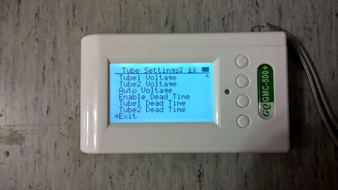

You need to go to the Init Setup, Tube Settings, High Voltage Display. Then Enabled.

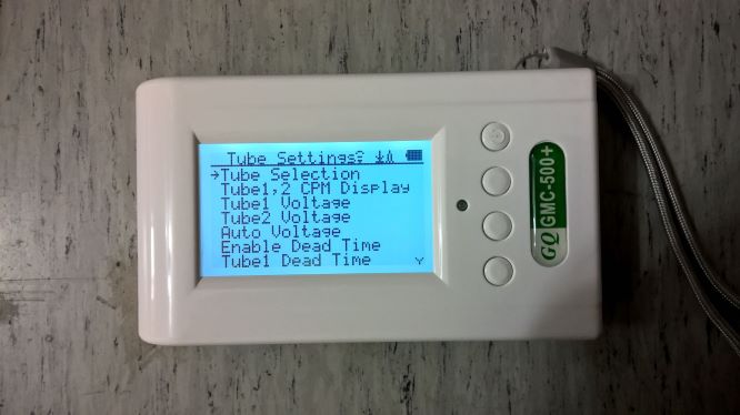

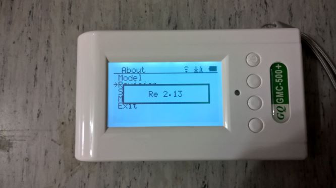

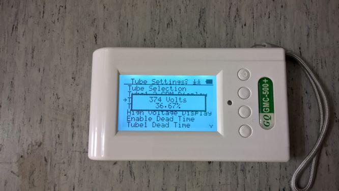

Hi Stargazer 40, thank you very much for the guide, but I think I like the version of my device is the problem. I haven't found all of the High Voltage Display. I'm posting below a few pictures of the device and the version of the software. thank you very much again, I really appreciate it.

Gelu, does the tube voltage 1 still show percent without voltage? Can you please re-upload the images in #3 reply for some reason they're not showing.

Hi EfmDev, unfortunately, the versions of the software, Re 2.12, respectively, in Re, 2.13, on which I have received from support, it didn't solve the problem. It does not exist in the menu, the function of the High Voltage Display. Re-uploaded the images and some other pictures. Thank you very much. I really appreciate it.

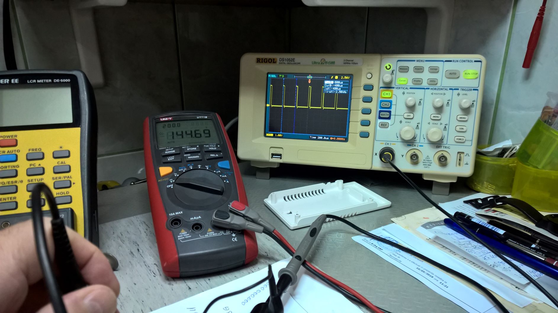

I notice that the photos don't load, I don't know what it is. In the second picture, I measured it with the oscilloscope, the shape of the signal on Pin 4 Of U1, to the CPU
I've done it, I'm very sorry for the inconvenience. I was wrong about the resizing, I'm sorry.

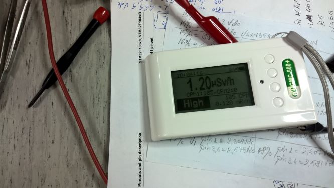

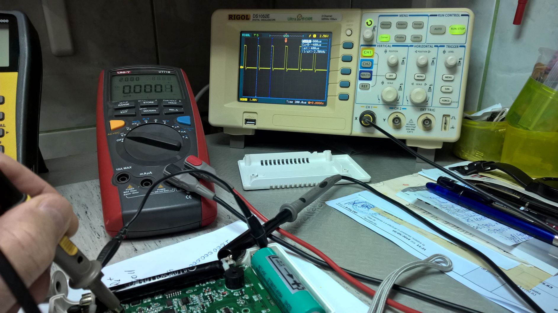

Hi EmfDev, thank you very much for your help. The resistor has a value of 1GOhm. If you go back to my first post, and you're looking at the second picture, you'll notice that I've written down the values, in volts, as measured with a DMM with a 10MOhm impendanta of the input. The value of the High Voltage 358 is a high-voltage, I measured it with the probe of a High Voltage, with the ratio of 1/1000. I'm posting a picture of what I have written above. Thank you very much for your understanding.
P.S.The scope of the DMM is set to the manual is 2 volts.
And one more detail, the value of the volt after resistor of 1GOhm, as measured by the probe, a high voltage is 0.0036 volts. If you might be missing the resistor R4 of 10MOhm on the PCB, the value in volts as measured with a DMM it would be a 3,59 volt. I think the hardware is ok, and I hope to be like that. Thank you.

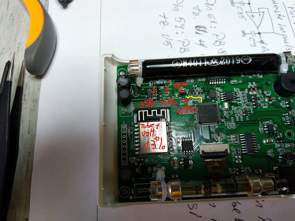

Posted - 09/05/2019 :  00:25:02  Show Profile  Reply with Quote
Originally posted by Gelu
I see, was that initially what the support suggested for the DIY?
Hopefully by tomorrow or next day we'll make your unit work.
Hi EmfDev, and I hope that the support engineers, in the following analysis, with which I post, to make that version of the software, so that I can read, a High Voltage Display Tube 1. I'd like to think of it as a version of the software to the current Re 2.13 can make control of the High Voltage on the Tube 1 . Now, in the wake investigation that I've done, I can't be sure that it is up and running. I look forward to the resolution of the problem. Thank you very much for your help, I appreciate it.

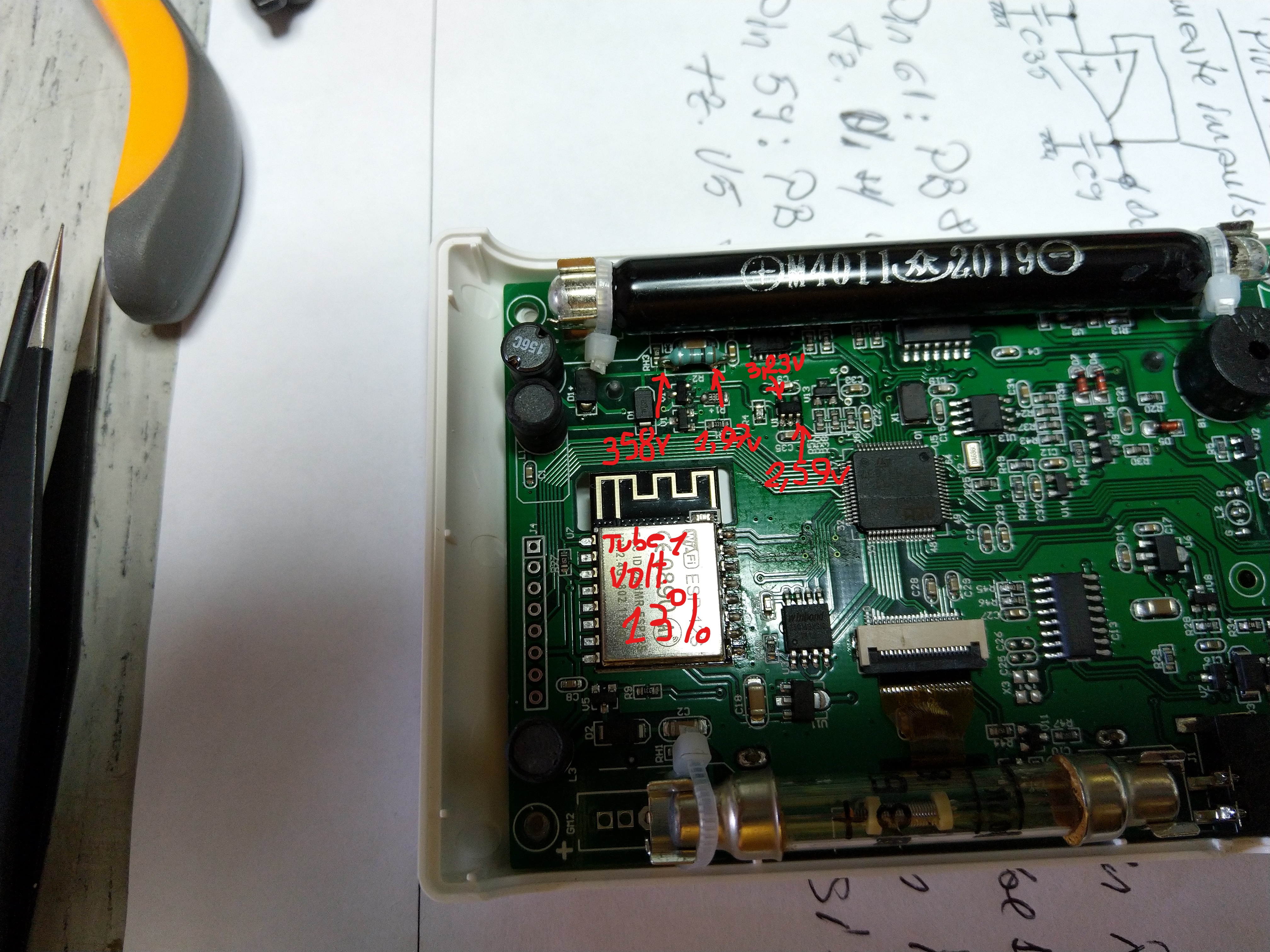

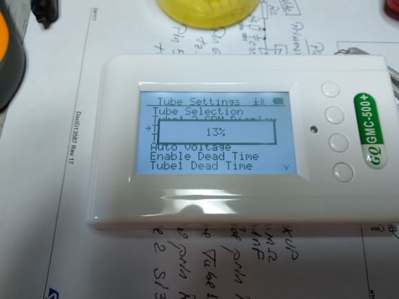

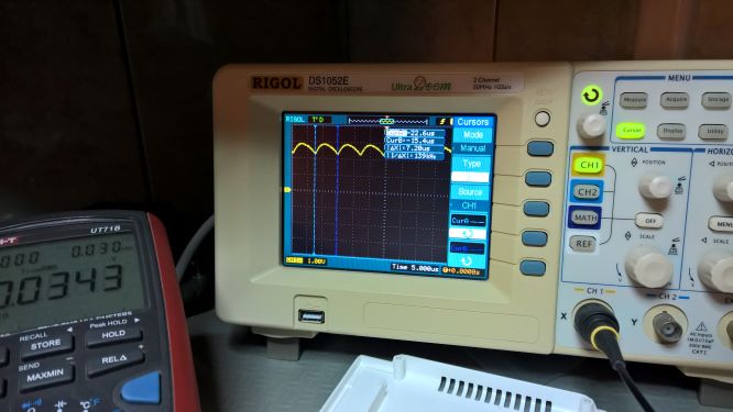

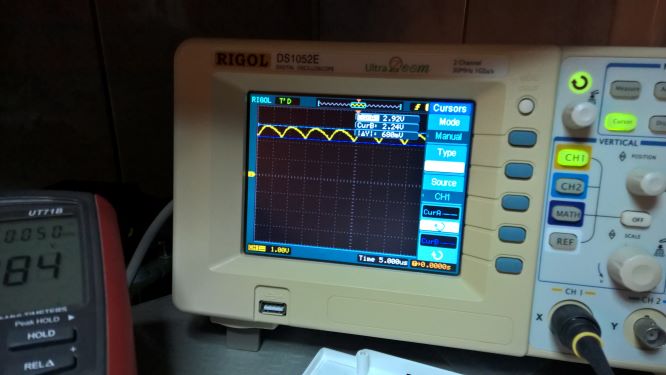

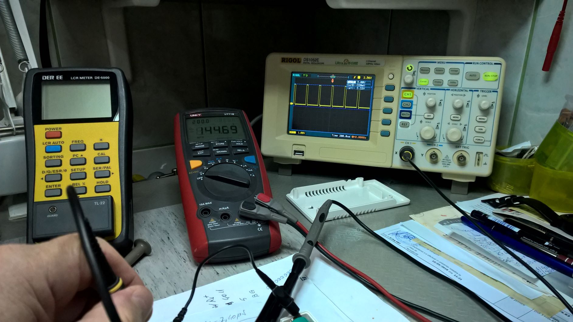

Hi, I'll be back with our next analysis which I have made to Control the High Voltage (DIY), on the Tube 1 M4011. What do I need to take Control of the High Voltage? The CPU analyzes the value of the High Voltage with the help of. Pin 14(PA0-WKUP). If the Tube M4011, asking for an increase in consumption, the value of the High Voltage tends to decrease, then the CPU takes the decision to increase the number of pulses in the base of the transistor U1 through Pin61 (PB8 I/O). We have simulated the collapse of a High-Voltage by measuring it with a DMM at the end of the Tube1. I haven't seen any reaction on the part of the CPU. I think that the CPU doesn't know how to respond if you do not have a built-in program, or if the wiring (DIY), it's not working. I'm posting below the photos of this test. Thank you.
P. S. the Setting of the Voltage Tube1 is at 13% (359 volts to be measured with the probe of a High Voltage.)

Hi Gelu, I've speaked to our engineer now and said that the circuit should work as it is.
Make sure that these 2 pins are connected together. From the 2.59V and 3rd pin from the left of the processor.
313557 bytes
Edited by - EmfDev on 09/05/2019 09:28:46

Hi EmfDev, thank you very much for the suggestion, but I checked it out a long time ago, if there was a connection and that connection is. On the PCB U1 (Pin3,4) is connected to the CPU (Pin14-PA0 WKUP). I'm just curious if you looked at my post from before. There I have drawn two conclusions can be made: 1. the either the CPU does not have the appropriate program for the Control of High-Voltage and High-Voltage Displays. 2. or the circuit of the DIY's I've done , it has a problem. This device has been built with the DIY, that is a project for the future, and it's probably the version of the software is different. The CPU doesn't know what to do with the information received from U1 (Pin3,4), and I think that's the problem. Thank you very much for your understanding. I appreciate it very much

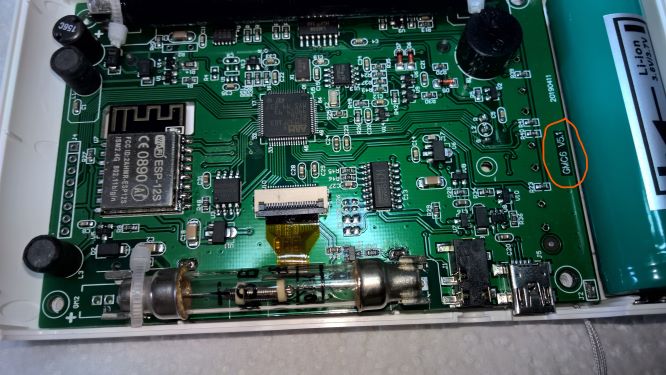

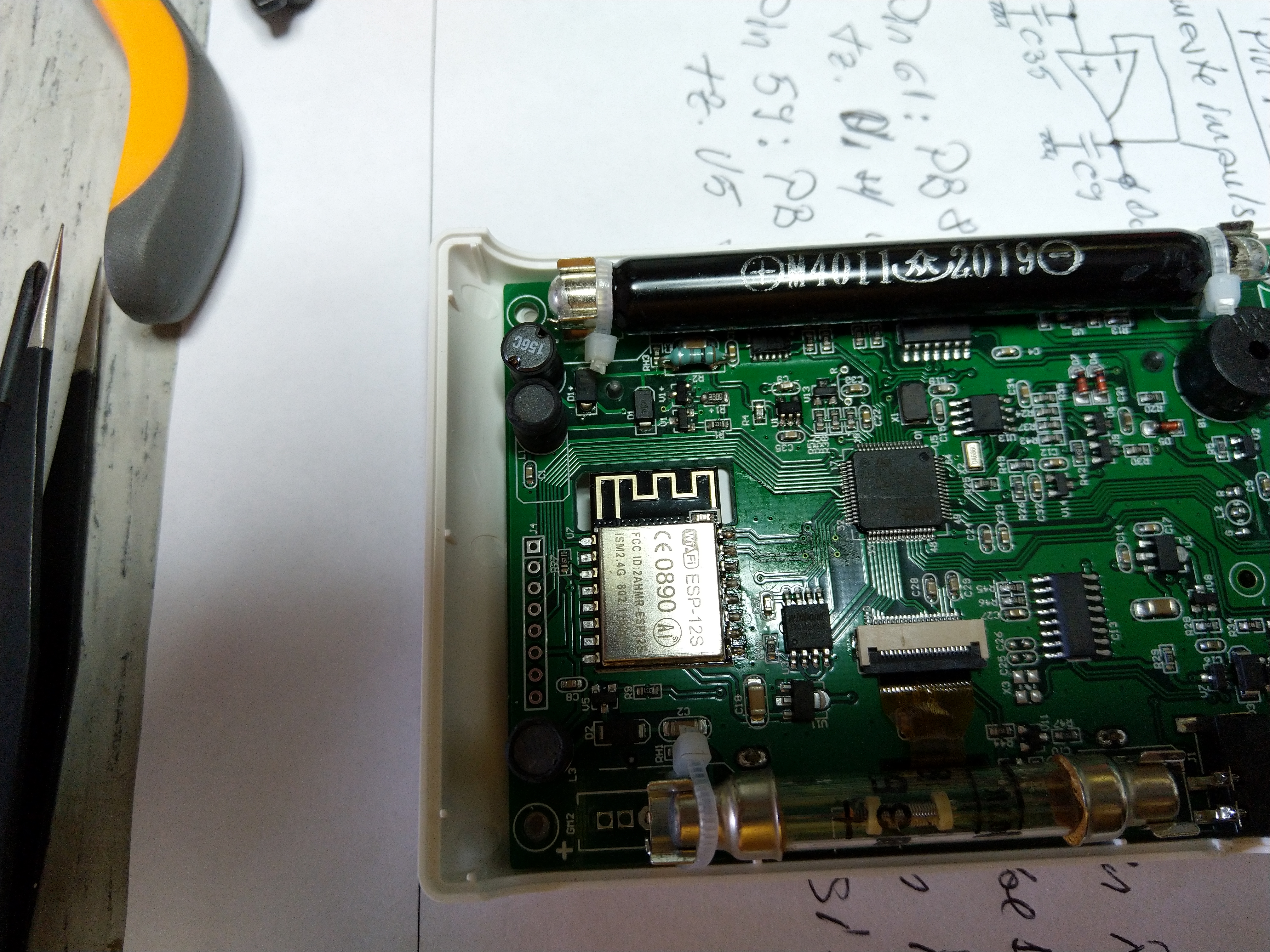

Do you have a 5.2 PCB? Shown on the right hand side of the board above. That and the presence of the 1GOhm resistor preclude your first conclusion above. @EmfDev - Did 2.13 upport the voltage readout on text?

Hi Stargazer 40, I have the ver. 5.1 PCB, I'm going to post a picture of the PCB before making the DIY. I just want to let you know that I solved the problem with the help of EmfDev, and the support team. I'm going to post pictures of you with this problem. Thank you very much. I really appreciate it. Thank you

@Gelu - The DYI you performed was to add the inductor, diode and transistor to the 5.1 board to power up the second leg of the tube 1 power supply? Are you saying that didn't work? Did you get parts from GQ?

On my GMC500+, the inductance and the diode are missing in the upper left corner. Hopefully, the high-voltage display on the text screen will still work.
If I need the missing components, would the values be interesting?

Just to comment on the missing inductor, diode and transistor. Does not affect the HV readout at all. It is to add another leg to power supply so that more current is available to the tube. With the additional leg of the power supply enabled there will be faster recovery of any voltage drop due to high CPM with Auto Voltage Adjustment Enabled.

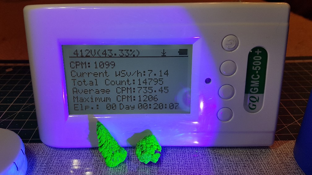

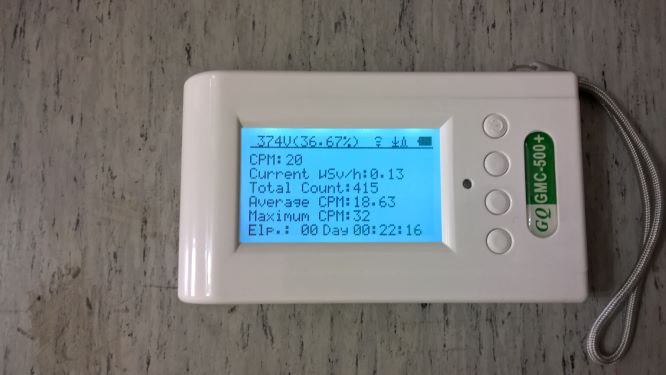

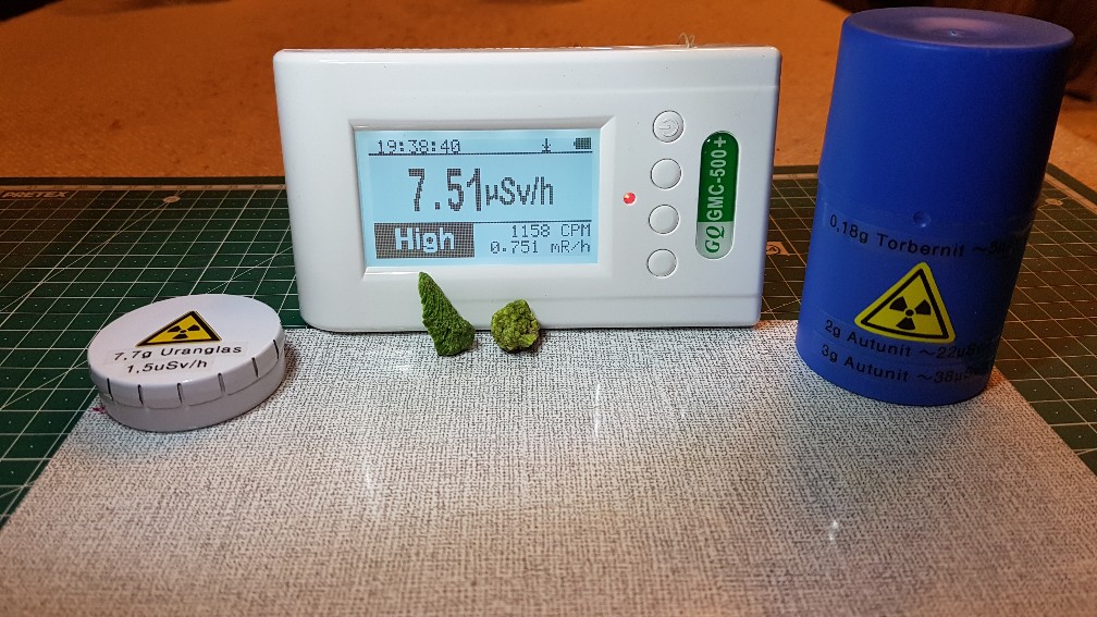

So voilą, here is my GMC500+ with the voltage indicator in the first line of the text screen. In the foreground 2x Autunite pieces and left and right my protective container.
Normal Light
With UV Light
First Line with voltage indicator
