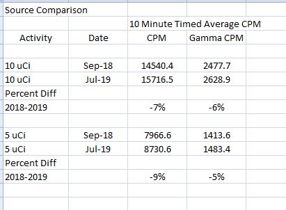

So total counts from zero divided by minutes is good for me. The ACPM was a little disconcerting.
Today I received another 10 uCi source and another 5 uCi source. The first two I got back in September of 2018. I did Timed Counts at 10 min. For the raw disks into my LND 712 wand grafted into the 500+ V1 I got the following table. To the right are the gamma only CPMs with 3mm of lead plate and 6mm of plexiglass in between.
26984 bytes
There is a large +/- associated with these uncalibrated sources so the expected difference due to the ten months difference in manufacturing dates of -2.6% is lost in the noise. Still the old ones are up to 9% lower than the new ones. These are Cs137 so HL is 30.8 years.

Posted - 07/30/2019 :  15:58:48  Show Profile  Reply with Quote
Looks like the difference is too high. I wonder what would the V2 would read.

Posted - 07/30/2019 :  16:19:23  Show Profile  Reply with Quote
Certainly the difference is more than I would like it to be for both activity levels. It's different enough that I need to specify which of the sources I am using in any analysis or tube or meter comparison. I don't think V2 would give any meaningful difference in counts. I am in discussion with the maker of these to get their opinion if this is too much (I think they will say within tolerance for a non-calibrated source).

Posted - 07/31/2019 :  08:36:28  Show Profile  Reply with Quote
Hmm did you measure the 10min counts from the old samples when you got then last September?

Posted - 07/31/2019 :  12:13:05  Show Profile  Reply with Quote
No, I just looked for counts to stabilize. It's one of the reasons I'm redoing a lot of my numbers to get the average over 10 minutes. I think it will improve the calibration numbers.
