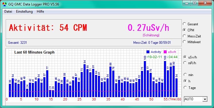

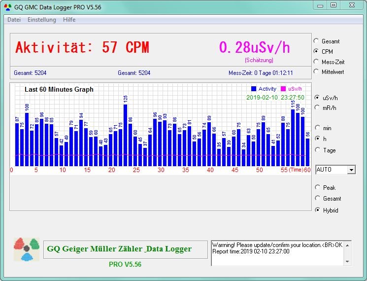

Hello,
I have higher CPM readings in my home than I had before. I tested my Geiger counter GMC 320 Plus V4 in an other house where the counting was normal and everything is ok with the Geiger counter.
Here are some screenshots from my measurements:
123266 bytes
101867 bytes
What would you recommend ? Should I leave my house or is this usual ?

Posted - 02/14/2019 :  12:46:18  Show Profile  Reply with Quote
Hi Ger_aki75, what was the your previous cpm at home? Did you test for longer time at other places? like 1day or 2?

Posted - 02/14/2019 :  13:25:44  Show Profile  Reply with Quote
Yes I tested several days in an other house and in the other house was no higher count than ca. 65 CPM but only in several single minutes, and the average in the other house was at 38 CPM.
It was about the same CPM readings like in my house before, but the last days and weeks the CPMs are getting higher in my house. I think the Geiger counter is all right.

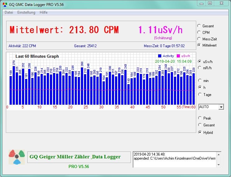

Hallo,
I was watching my CPM counts the last weeks and month, it is getting higher and higher.
In my house I have average readings up to 200 CPM now all the time.
127568 bytes
And at other places outside the house I get readings up to 1000 CPM, but when I leave this area the Geigercounter gets down to 150 CPM immediately. But temperature seems to be a factor too. I put my Geigercounter in the refrigerator to test that influence, and at 5° Celsius after 15 Minutes it showed 1800 CPM.
So I really dont know what it is. I mean I live in Bavaria and we were really hit by Chernobyl quiet hard (we still cant eat wild boars because of contamination). But I dont think these readings are correct.
But what is frightening me, is that thing with that spots outside where the Geigercounter jumps up to 1000 and higher, but the Geigercounter drops down to 150 and below immediately when I leave the Area or get in a car. This cant be related to the temperature. So I really cant figure out if it is the temperature or something else.
