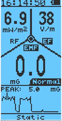

I have just bought a GQ EMF -390 meter. I am confused as to how to apply the guidelines for acceptable levels of exposure to High Frequency electromagnetic (RF) radiation. A level of #8804;0.001 mW/mē seems to be an acceptable level quoted by BUILDING BIOLOGY PRECAUTIONARY GUIDELINES (SBM-2015) For Sleeping Areas, as well as the Austrian Medical Association EMF Guidelines. But is this for the whole RF Spectrum combined, or per frequency band, or for each individual frequency? I live in an isolated rural situation in NSW, Australia with our nearest neighbour 2Km away, no mobile phone or television reception and no WI FI or wireless devices. We have stand alone solar electricity and no mains connection. The 390 in Allinone mode shows approx 4.0 (3.9-4.1) mw/m2 almost all the time, inside or out, close to the house or at great distance.

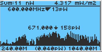

This seems a very high reading, compared to the guidelines, for this situation. The only time it changes is when I plug it into my laptop when the value climbs to average 5.5. Then when I turn on GQ EMF PRO the value climbs again to 6.5. These values fall again when GQ EMF Pro is turned off and the meter is disconnected. When I turn on a mobile phone in the vicinity of the meter the reading stays at 4.0 unless I am in range of a mobile tower(I tested at our nearest tower 18Km away). In RF Table mode the screen shows 0.062mw/m2 at 780Mhz as the top reading. Again this seems a high reading for this apparently RF clean situation.

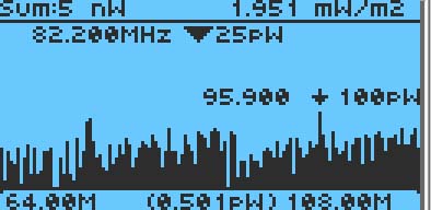

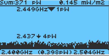

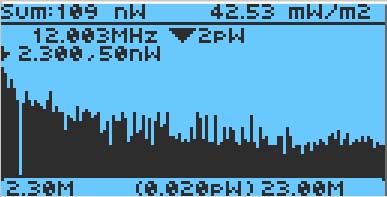

When using the RF Spectrum mode I get the following graphs.
If the values at the top right of the graphs, which seem to be the sum of mw/m2 for each band, are added together the result is 8443.743mw/m2. How does this relate to the RF reading of 4.0 mw/m2 in the Allinone mode. The default value for the 390 for the RF alarm is 123.33mw/m2. Is this an arbitrary value?

I'm also a new user, but in a much more urban environment, not too far away from a cell tower. I don't have all answers but I can say I have the same worries about the constant 3 to 4 mW/m2 reading (AllInOne mode) -- with bursts going way up above 100 mW/m2 (that I guess is the cell tower).
I also identify a safe level as < 0.15 mW/m2 (or less).
Moving around in the city I never get a reading below 3 mW/m2.
I also don't understand why the Sum of the Analyzer Sums (values in first line on the right in mW/m2) is far greater than the mW/m2 value on the AllInOne screen (which seems already high).
I am less concerned about the fact that pluging in the USB cable creates an antenna which raises the readings.

That 4.0 value is because we added the values for the 2.4GHz, 240MHz band and up to 10Ghz band and NOT INCLUDING the bottom 4 from the RF spectrum. Some of them can just be noise from the chips(minimum dBm limitation) and all of those can add up to a lot.Try to get a radio to play some stations. If the radio works, then there RF signals in your area.

Thanks for your answer. As the Allinone mode and (I have just realized) the RF Vertical mode include readings between .24 and 10GHz, can a rough idea of the reading between 2.4GHz and 10GHz be derived by subtracting the mW/m2 sum of the .24 and 2.4GHz RF Spectrum from the Allin one mode RF reading? Are you suggesting that the 780MHz reading I am getting is radio reception? My understanding is that Fm radio band is between 88 and 108MHz and that 780MHz is in the Ultra High Frequency (UHF)reserved for TV and Mobile phones, which we are out of range here..
2416 Posts
Posted - 01/23/2019 :  09:38:53  Show Profile  Reply with Quote
The RF reading in Allinone mode and RF Vertical mode .24-10GHz are the same. I don't think the 780MHz is from a radio station. It can be from cell phone tower? In our area, the peek in the 240 spectrum is at around 740MHz and 870MHz. If you get cellphone reception in the area, means there are still RF signals there.
If you want to you can read the RF Browser. It doesn't include the spectrum values.
