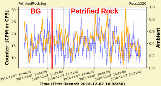

Thanks for the interesting links. It reminded me of the way wood is petrified, and since I had once bought a good sized chunk of it in Petrified Forest, Arizona, USA, I tried it right away with my counters using GeigerLog.
95019 bytes
The blue trace is from an GMC-300E+ counter with GQ's default M4011 tube, the light-brown trace from an RadMon+ counter with an SBM20 tube (a Russian standard tube).
Even without running the stat numbers you can see that the rock does not deliver any extra counts - just the same as BG (background), and basically the same for both tubes.
So, no success with my Rock :-( but I liked the idea.
