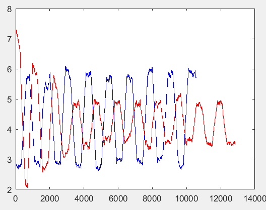

Posted - 03/08/2019 :  20:50:27  Show Profile  Reply with Quote
I have a similar problem with two GMC 300E+s. When I measure high count rates, like 240 CPM (from Thorium), I see a cycle with high and low counts over a period of about 600 seconds. Is there a firmware fix for this, or is 240 CPM too fast for this model? This graph's y axis is in counts per second for two 300E+ models.
18858 bytes

Posted - 03/11/2019 :  09:20:12  Show Profile  Reply with Quote
It's first time we've seen this one. It looks weird it seems. There are many factors to consider. But this is what the tube detected, so it can be the true reading.
