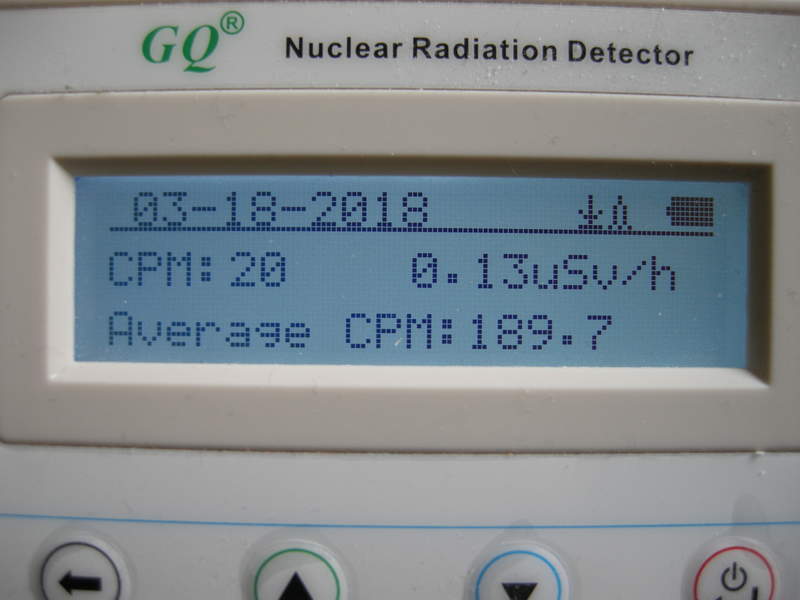

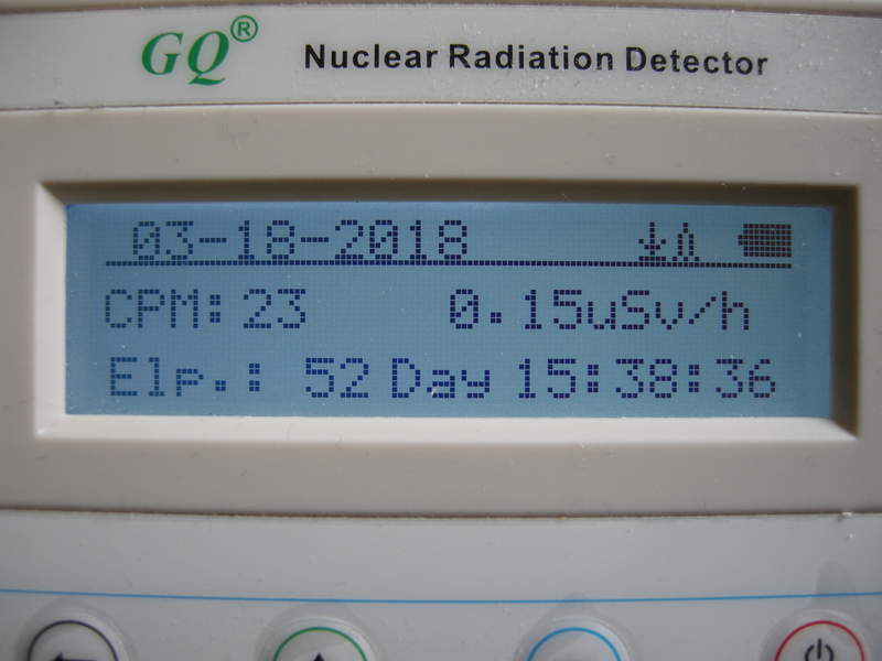

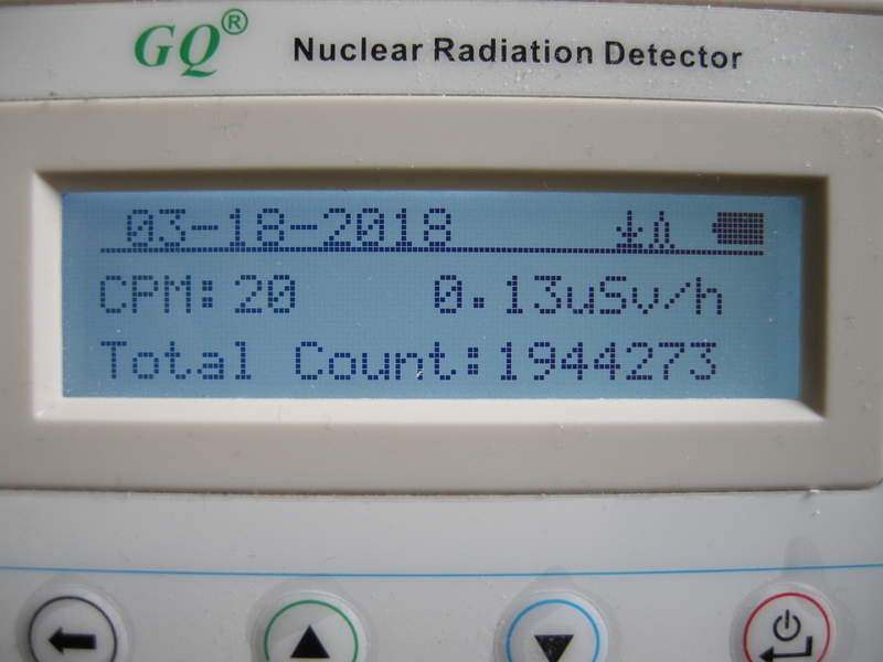

Hi All,
I've GMC-320 rev. 4.25 (without wifi) and I discovered wrong average CPM on higher uptime.
Uptime is 52 days, 15 hours 38 minutes, it means:
(52days *24hours * 60minutes) + (15hours * 60minutes) + 38 minutes
= 75818 minutes.
Total count is 1944273
Average CPM = total_count / total_minutes = 1944273/75818 = 25.64
But the unit shows Average CPM 189.7 (it's nonsense).
I think it's a bug.

Posted - 03/24/2018 :  09:49:40  Show Profile  Reply with Quote
I don't get how they can even release all those faulty firmwares... This was fixed in 4.2 as far as I know.
