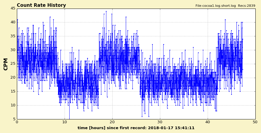

Going Cocoa:
102673 bytes
Continuing the "Going Banana" experiments by measuring household cocoa powder. Same experimental procedure as with the bananas. I think the graph leaves no doubt when the Geiger counter was put on cocoa, and when Background-only was measured.
Huuuh, cocoa is radioactive!
According to this link https://www.jameda.de/naehrstoffe/kalium/ banana have 420 mg Kalium per 100g, while cocoa has 1920 mg K per 100g. This is second only to low fat soy flour at 2015 mg K per 100g. Dried potato products (chips, flour,...) are in the middle with around 1000 mg K per 100g.
Can anyone provide a better measurement of such household items? Perhaps by putting a shield around the setup, could be lead, iron, aluminum?

You could extract the potassium. That would give you a way more accurate result.
Here is the method for bananas. h**p://sciencewithryan.blogspot.de/2014/09/33-peels-to-potassium-part-1.html?m=1 (For peels. But you could also burn the whole thing)

What a neat experiment, thanks for the link.
You will have noticed that this is exactly the original method to produce K that gave "pot ash" its name (which I adapted into my "Potty Training" ). But regarding accuracy you would need to know the preparative losses occurring; not easy.
But I don't want to determine the K content - that is known already - I want to use household and environment items to show that they do contain radioactivity. Though I must admit I expected a more significant effect. You can't really scare anyone by running a 3-day experiment and then use statistical hand wringing to show an enhanced radiative effect.
I am currently running "full potatoes", and I can say while there is an ehancement, it is again of the hand-wringing type.

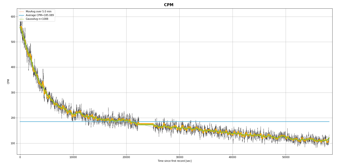

I did test the fresh dust from cleaning my CRT once. Here's a picture:
123130 bytes
Anyway. Ullix if you use this method you'll get a better measurement of the radioactivity of a banana or whatever. You just concentrate the potassium. If you simply put your counter on top of a banana you'll lose accuracy due to all the water and other stuff blocking most of the radiation. You'll get a quantitative measurement of all the radioactive stuff in a banana. I think this is the best way.
Except for the extra work. But maybe you want to find the easiest way? If not I don't know why you oppose this
PS: I still like my color scheme better :P Can you change colors in your program? This is an old picture from when I was testing my obsolete program, btw.

What on earth is your "dust from cleaning my CRT" giving you 600CPM? It would be a tiny amount of dust, hence it would have to have an enormous specific activity? And why does it have a half life of ~2h? Or are there even 2 half lifes? Describe what you did.

Dust containing radon does have two half-lifes. One from radon and the other from its doughter.
I don't know why it was so high. I guess it's because it was a relatively thick layer of dust and my counter is sensitive to alpha. Maybe I had my safe in the room at the time, I don't know.
