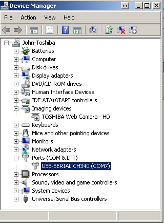

To check if the USB driver loaded correctly, you need to use Device manager of Windows.
See this:
53411 bytes
This picture shows the the USB driver has been loaded correctly and the comport is COM7.

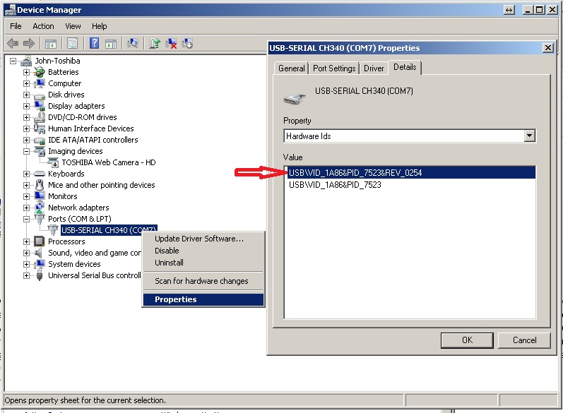

[b]Further verify the USB device ID:/b]
120190 bytes

I too am unable to install the USB driver. I get the following error:
"Cannot create DRVSETUP64\DRVSETUP64.exe"
I check device manager and I have USB-Serial CH340 (COM3) and when I check the details, Hardware Ids I have "USB\VID_1A86&PID_7523&REV_0264" and "USB\VID_1A86&PID_7523".
If you have COM3 present in device manager with right VID/PID, the driver is already installed and good.
VID/PID is VendorID/ProductID, is what windows use to attach a specific driver to a specific device.
