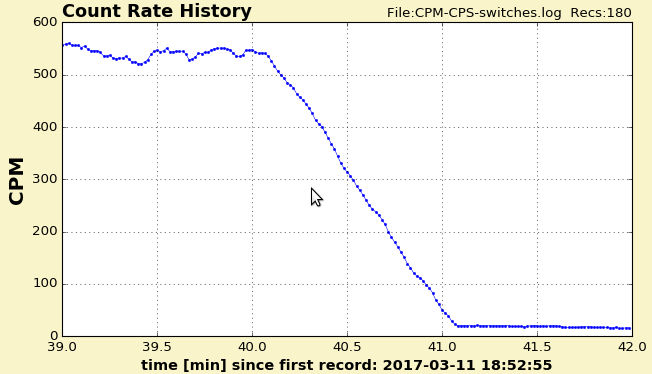

The tube itself adapts to a new radiation level within a millisecond or less, because that is how long a single pulse lasts. But in CPM mode the counter sums up all the events over the past minute, and hence it should adapt to a new rate level within exactly 1 minute. Compare with picture for a change from 550CPM to background. If it takes longer, then something else is going on.
