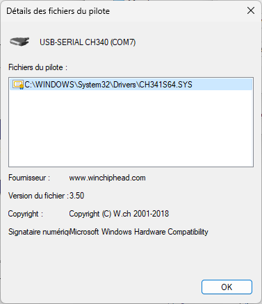

I cannot get "CH341SER.EXE" to work with WIN11; no com ports show as added
Posted - 01/09/2023 :  00:06:47  Show Profile  Reply with Quote
maybe the windows 10 driver must work under windows 11,
on my side it was installed under windows 10, I switched to windows 11 automatically, and I did not have to reinstall it, either it updated or it kept the old one but it works.
