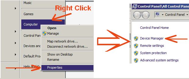

Windows 7 USB driver verification:
Right click on the My Computer, select Properties.

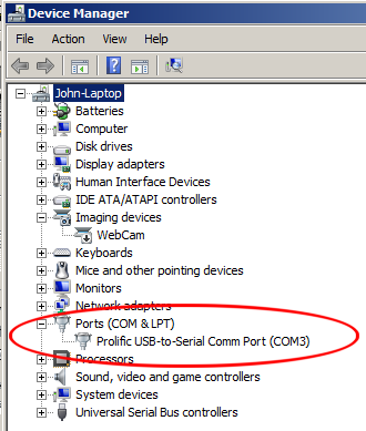

30.14 KB
this is showing the current communication port is on COM3.

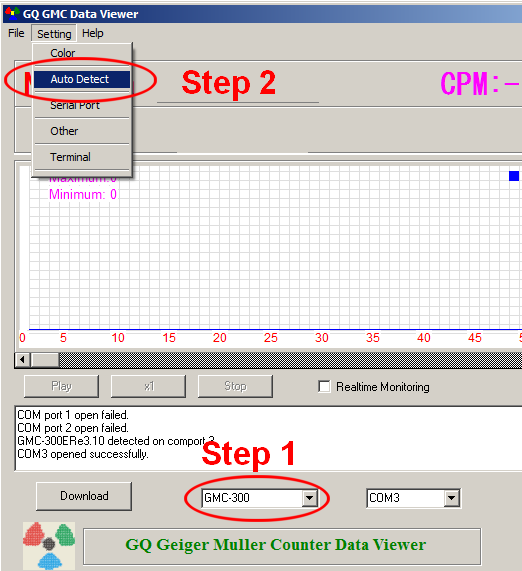

For GMC300(E), another way is to use Data Viewer auto detect the comport number:
33.92 KB
