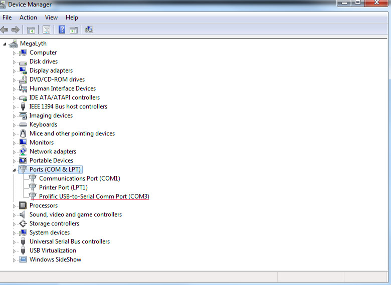

I have a GQ GMC-300 with firmware version 2.11 on a windows 7 64 bit computer. I'm having trouble getting the SoftGeigerCounterGMC300.exe software to read the data on the Geiger counter.
I have installed the Prolific USB-to Serial Comm Port driver successfully.

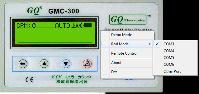

And I connect to the Geiger counter on comm port 3, but the software doesn't read any data off the counter. Also, if I set to a different port I don't get any error messages. (port connect error) but I don't get any readings either.
57.76 KB
Total flatline. I've tried this with 'remote control' on and off.

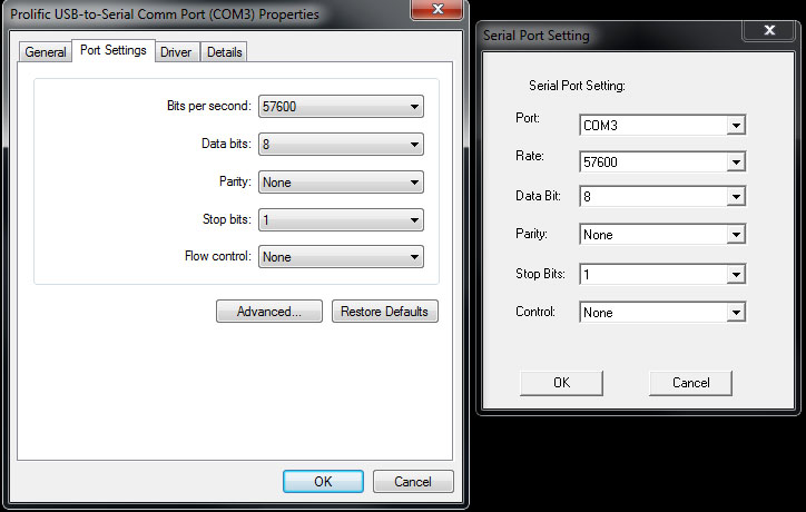

One last image, the panel on the left is the settings I get from the Prolific USB-to Serial Comm Port driver details in the device manager and the panel on the right is the comm port setting from the Geiger counter.
65.86 KB

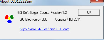

this is the version of the software I am using:
18.95 KB
still no results

Still can't get the data viewer or the virtual Geiger counter to work. I am using soft geiger counter v 1.2 and the fireware version of on the geiger counter is 2.11.

I see that you did not select Remote Control in the soft geiger counter.
Try to select that one.

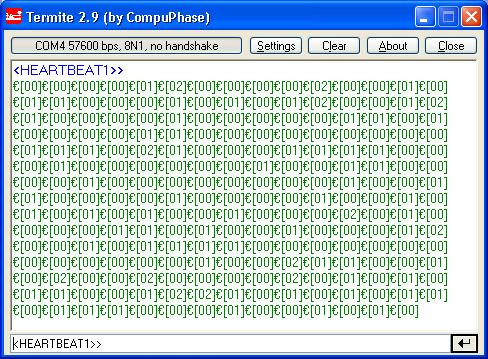

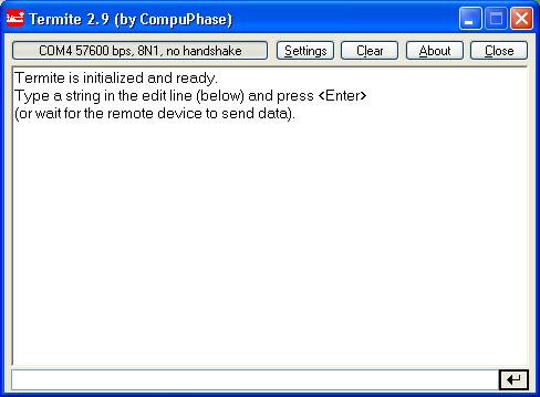

Download a terminal program like Termite and configurate the right com port and baudrate for your GMC device. http://www.compuphase.com/software_termite.htm
26.29 KB
If connected and you see the screen as above then the GMC-300 has no Heartbeat and you have to turn it on with the command <HEARTBEAT1>>
Sometimes you have to give the command more then one time till you see the Heartbeat like in the picture below. Every €[0x] are x counts per seccond given by the GMC-300.
