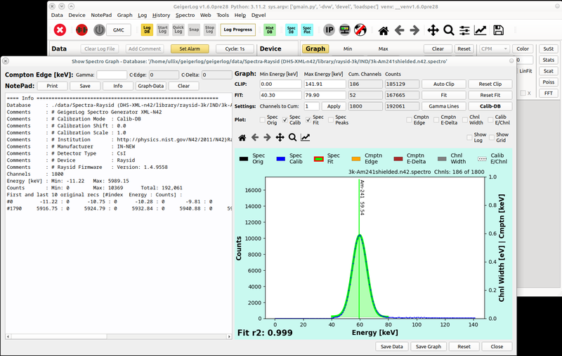

The latest development versions of GeigerLog do support Gamma spectra. Here is one from Americium-241, showing its very prominent 59.54 keV line, and the near-perfect Gauss curve fitted to the peak:
Note how well it is defined, despite the low Gamma energy, being in the realm of X-ray from a doctor's office!
