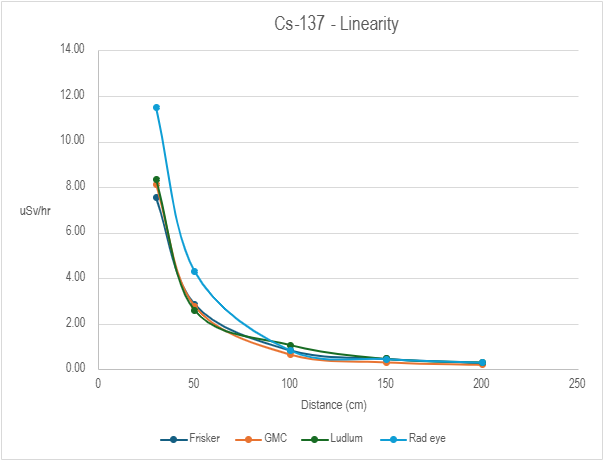

We've recently purchased GMC-500+ to compare it to couple of our existing detectors.
On CS-137 the readings were very similar:

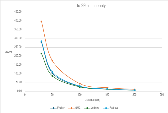

However, on Technetium-99m, it was much higher to the others. Particularly compared to the Ludlum which is our most accurate:
Do you think this is just to do with the different energy levels of tc99m vs cs137 and no compensation for it?
Thanks in advance.
