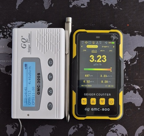

However there's especially one bug that really bugs me. "Fast Estimate Dynamic" is really buggy. I can have a static object (one of those infamous thorium filled Chinese wands) sitting on the table against it.
My 300S also set on dynamic mostly fluctuates +/- 0,1 uS/h when settled down - on rare occasions +/- 0,2. That is expected behavior.
The GMC-800 on the other hand. It should read about 4 uS/h depending on placement (beside or below, even give or take a mm in distance to tube result will vary noticeably). It it not really stable. It mostly fluctuates around the expected reading but within any given short timeframe (10 sek or so) there's also huge variations as high as almost 6 uS/h and as low as 2.30 uS/h. LED flashes and it clicks like expected - no odd thing noticed there. So there's certainly a bug in algorithm. A little better if choosing fixed intervals although at 15 sec fluctuations are still a little larger than I'd expect.

I'm a bit surprized that nobody responded. No one else with GMC-800 ?!
I did a 3 minute video on the issue and comparing it to the 300s using one of my strong nano wands.
As can be seen the 300s has no issues except a tendency to overshoot at first but thereafter readings remains stable within expected fluctuations.
On the 800 however readings fluctuate between 3.something and 5.something uS/h. Even as low as 2,8 uS/h - even after a minute and more at which readings should have had time to stabilize. From its clicking I don't observe any oddities - but readings are if not all over the place then quite spread out.
Is a new firmware in the making? It's relatively unusable as it is right now.
https://youtu.be/tkkfH3qrxJk
Posted - 08/19/2024 :  10:22:20  Show Profile  Reply with Quote
Hi Kaninbjerget, sorry it looks like i missed commenting on this post. we are now working on the dynamic estimate to be the same as the 300S. For the timed count and accuracy display, we will check with the team.

Thanks a lot! Just updated to rev. 1.11
Can confirm that fast estimation is now working a lot better - much more stable.
Other bugs seem to remain though.
