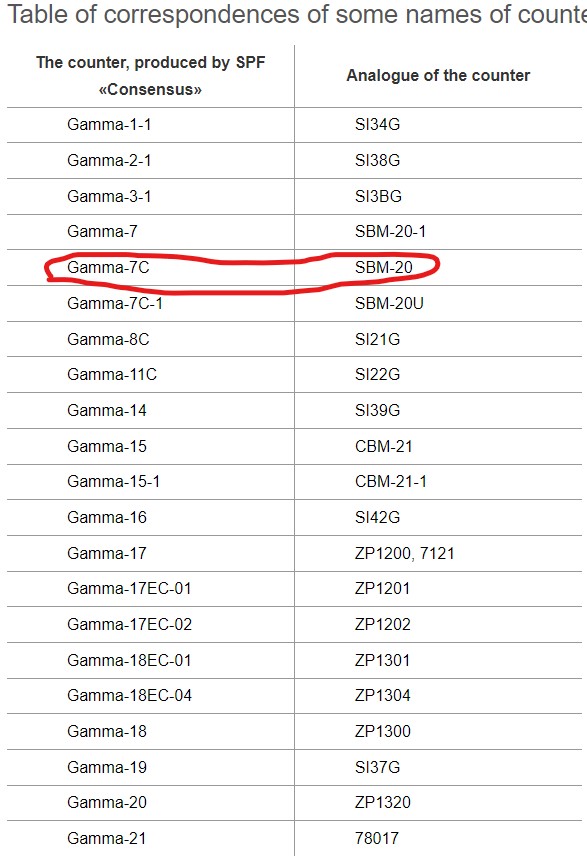

Has anyone tried the Gamma-7C by https://consensus-group.ru/radiation-counters/gamma-radiation/gamma-base/256-gamma-7c havent heard anything about it as a replacement for the SBM-20
Rhett A
nonus
38 Posts
Posted - 07/10/2024 :  21:32:47  Show Profile  Reply with Quote
Yes, this is a replacement for SBM-20.
