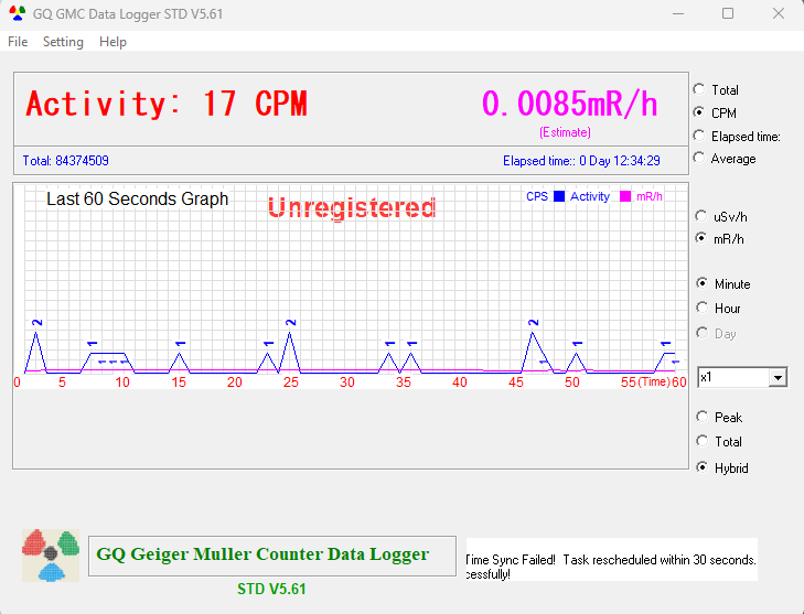

On the previous Windows pc, I had my GMC-500+ working and showing up on the map. That pc died a while back.
Since then, I built a new one using Win 11 Pro. I downloaded the GMC Data Logger STD V5.61, set it to the correct COM port. For a while I was getting CPM counts on the app. The app says
COM3 opened successfully.
Heartbeat started..
Realtime monitoring started.
connected on COM3@115200.
but now there's no readings although the counter is clicking regularly, and the counter display is showing about 18 CPM, consistent with other stations nearby.
I am not using Wi-Fi for connection. I am using the USB cable with the counter on COM 3.
I get the "WiFi send data failed" every few minutes, although I am not using Wi-Fi.

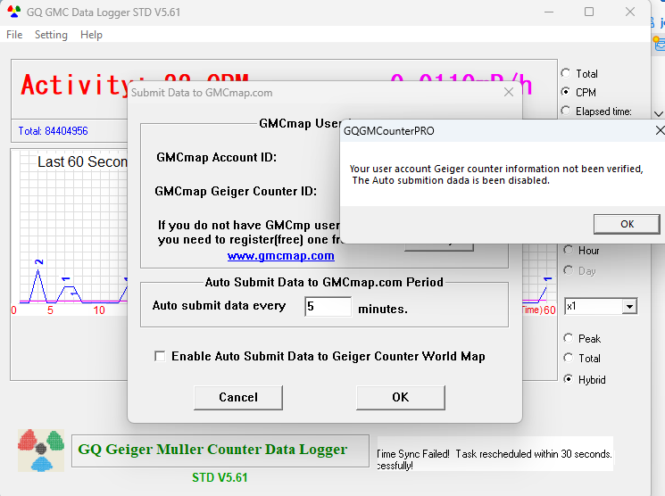

So, I went to my data logger software, put in the account id from my profile and the geiger counter id from the same place. I get this.
Now what?
Cheers - Jon
Posted - 05/14/2024 :  10:03:44  Show Profile  Reply with Quote
That means you may have entered the wrong information. Please double check your account number and geiger counter id on your gmcmap account.
