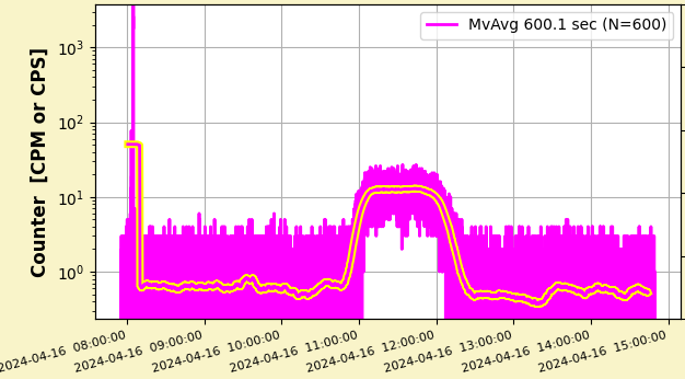

This is NOT generally true! Attached pic is an example flight recording of CPS with a GMC-600+.
Note that I applied log scale in order to make the flight data visible in the presence of the monster X-ray scan peak of CPS=3603!
There are several more examples in the forum of users happily using their GMC-600 on flights.

I’m not saying the flights are a problem. The TSA X-RAY SCANNER is! I left the power on accidentally and the machine killed it dead.
