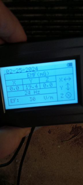

Attached is a picture showing the "y" axis is malfunctioning as it always has. Re-orientatioin does not chage this. I can't explain why this reading looks as usual, though obviously faulty, while the car measurements are now too low. I reset to factory default as well without change.
Please see picture.

The EM 390 shows higher readings compared to the Trifield meter, likely because it detects frequencies as low as 30 Hz. These lower frequencies might have more significant health implications, although it's still debated.
