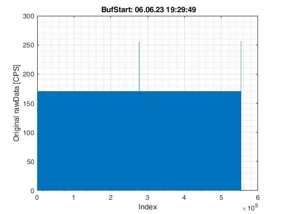

Dear All, my new counter (GMC-320+V5 RRe) works well. Just a simple question, not a big issue, but an issue: In the downloaded data are FFs which are no valid data. Not at the end of a buffer, now buffer wrap arround, just in between (see the figure attached). Hence, what is the reason and how can I avoid this? Thanks for your advice in advance. Erwin

Thank you for the advice. The FFs should occur at the end of a buffer. In your example above, the last FF is at the end of buffer 15 (61440/2^12), ok. But the ring buffer is not active in my data. The incriminated FFs range from 277434 to 277441 (8 total) and these are more or less in the middle of the 67th buffer. So definitely wrong. The end of data FFs are between 554245 and 557056 (136th buffer), ok also. The intent of my question is if anyone has also observed this behavior and if it is due to the counter's internal workload (sleep, download, key input, etc.) which I can avoid.

Just to close this item: After several run-throughs of the whole memory it never happens again. Seems it was an accidental error. The counter works fine and I'm happy.
