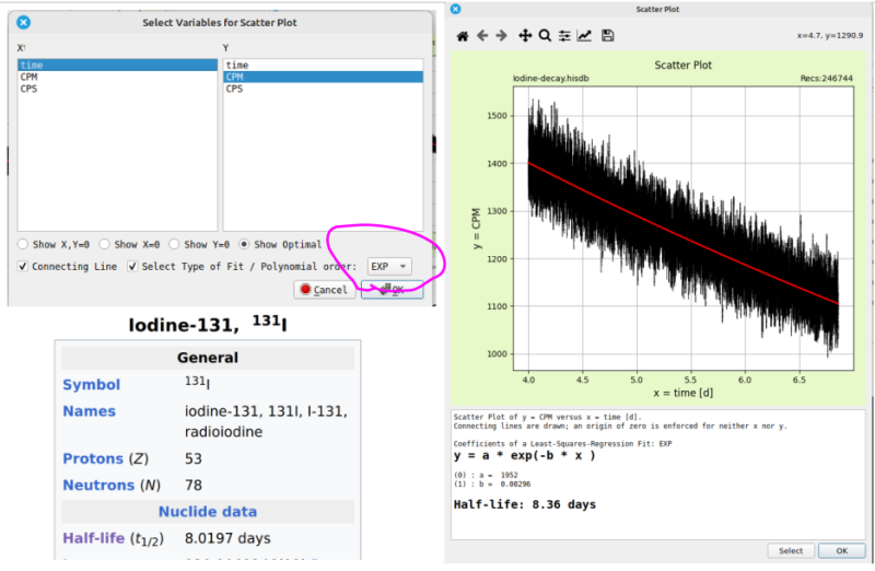

A GeigerLog user has kindly provided me with a set of data recorded in connection with an Iodine-131 treatment of a cancer patient.
First, the count rates are very high, and are likely to initially overwhelm the counter! Second, with a half-life of I-131 of about 8 days, the decay is easily visible in recordings which last longer than a day.
GeigerLog has the feature of making Scatter-Plots, including least-square regressions to polynomial curves. I have now added the ability to make regressions also to exponential, like relevant for radioactive decay, so you can derive the half-life from your data very easily.
Click the "Scat" button and select time for X and CPM for Y, then select "EXP" for type (bottom-right), and click Ok. The data, fit, and half-life are displayed, as the pic shows.
A half-life of 8.36 days is calculated, versus the true HL of 8.02 days.
This is possible only with the latest pre-release #36 of GeigerLog, which you can download here:
https://sourceforge.net/p/geigerlog/discussion/general/thread/beafedc7b1/?page=4#e2e8
The releases change frequently; look for any later one.
