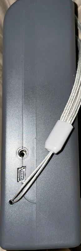

I just received a GMC-600+ It turns on ok and the date was set correctly. I charged it up but the S4 on/off button does not produce a menu. The counter does seem to be working but without a menu I can't change anything. The hand strap was not connected. Not sure how to connect it.

As far as the hand strap it looks to me like it is installed during manufacture requiring disassembly which I would not recommend you do since your unit is under warranty. I would recommend sending it in and requesting a NEW replacement.
