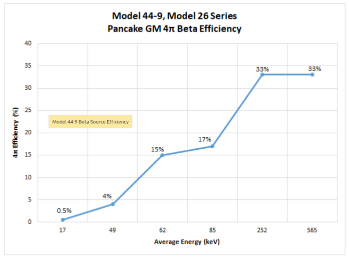

The Ludlum page (https://ludlums.com/products/all-products/product/model-44-9#graphs) is actually giving you more details on the tube than LND itself. First you see the energy response curve for gammas, and then for betas, shown here:
Remind you that the gamma sensitivity is in the sub-1% range! All Geiger tubes are much, much more responsive to beta!
