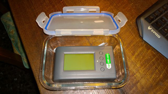

i had seen the video, but my tube is explosed for a violent closing of the door which created a suction of air.

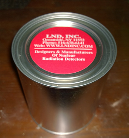

LND inc. sent me the tube in a sealed paint-like can!
NOW I PRESERVE MY GMC 600+ IN A SEALED AND STIFF GLASS BOX.
(CAN WITHSTAND AN ATOMIC EXPLOSION!!!)
I recommend it to all mica pancake owners.
if you bring it by car, open the window before closing the door.
