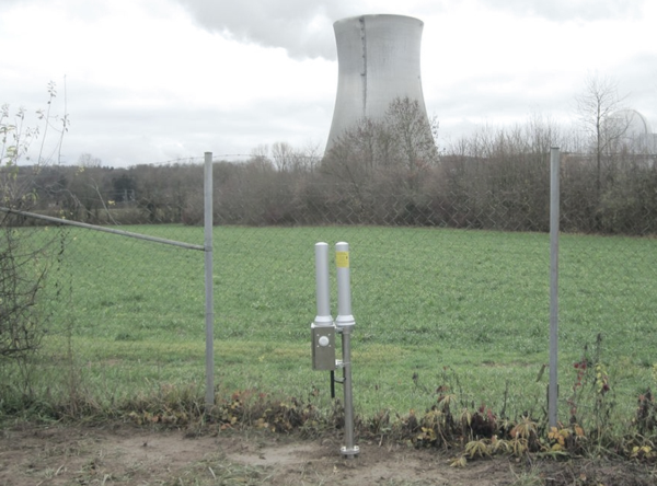

Best place to put the counter is somewhere outside, away from buildings, forests, any other obstructions, protected from rain, sunshine, etc. Something like in this picture in the foreground:
https://www.bfs.de/EN/topics/ion/environment/air-soil/odl/odl_node.html
Chances are pretty slim that you would ever come close to such station quality using a GMC counter.
