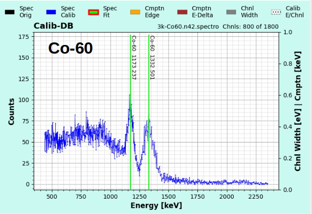

You can really make a difference of 10x and even more sensitivity by moving to scintillator devices.The most prevalent are based on CsI(Tl) - Caesium-Iodide crystals doped with Thallium. When a gamma quant is absorbed in the crystal it triggers a light pulse. This pulse is detected by a photo sensor. The Radiacode devices https://www.radiacode.com/de are based on this technigue. Their sensitivity easily passes that of pancake detectors! Also, I can't think of a mechanism which makes them vibration sensitive.
You can raise a topic in this forum with a question on those crystals. I know of some people reading this forum, who are trying to build an open-source crystal device!
But not only is such a crystal device a more sensitive replacement for a regular Geiger counter, one can also generate gamma spectra with such a thing, allowing you to identify the radioactive source!
The light-flash intensity is increasing with gamma energy. Combine your electronics with a MCA (Multi-Channel-Analyzer) and you have spectrometer! The ESP32 built-in ADC might suffice for that.
GeigerLog can help you there as well. The most recent development versions - presently prerelease 1.6.0pre27 - (https://sourceforge.net/p/geigerlog/discussion/devel2/) will help you. As example here a Co-60 spectrum:
I will support any new achievement with GeigerLog.
