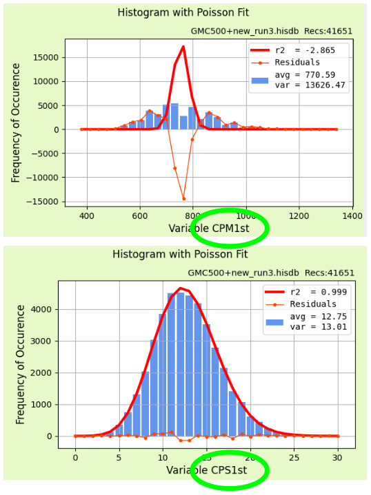

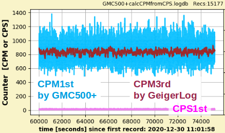

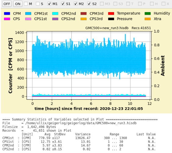

I did a first run with the result shown in the pic:
At first glance it looks ok, except that the scatter seems to be a bit wide. Printing the Summary statistics (Button 'SuSt' in GeigerLog). shows the CPM1st average as 770, while the variance is at 13600. Wow! the two should be similar, this is a huge difference!
Strangely, the CPs1st got 12.75 and 13.01, resp., truly kind of similar, as it should be.
This is begging for a Poisson test, and here is the result:
Oh dear.
The CPS data look proper: r2=0.999 - surely close enough to a perfect 1.0 - and average 12.75 almost the same as 13.01. It doesn't get much better.
However, the CPM data are a complete mess. While the average of 770.59 is in line with CPS=12.75*60=765, everything else is complete BS.
This is the worst I have ever seen in any counter, be it a GQ counter or any other, including low-cost counters. This GMC500+ is unusable as it stands!
Since the CPS data - so far - look correct, it seems that a major, major bug has been introduced into the firmware, when it comes to calculating CPM.

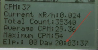

What I also find strange is that the clock deviates by more than 20 sec over only a 12 hour period. This is as bad as or even worse than the old GMC300 counters, but this counter supposedly has a real time clock built in, which should be much more precise. Or have they not? Are the two problems related?
I wonder if anyone else has observed this weird effect on their counter? While this is firmware 2.24 on a GMC500+, I guess that the 2.XX firmwares will be similar on all counters. Measure anything and make a Poisson test.

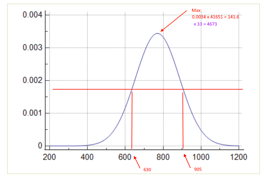

Hi ullix,
I don't understand your first Histogram with CPM data,
apparently the two diagrams come from the same measurements made over 41651 samples (with 1 sample/sec) so during 11.57 hours.
To build CPM histogram, we should group the CPS data in packets of 60 by adding them. we should therefore end up with statistics over 694 values of CPM, but on your CPM histogram we remain with same overall count of 41651 events (samples).
Out of curiosity I plotted the Gaussian corresponding to the following data:
avg= 770
sd= 13626^1/2 = 117
with this following link: https://www.medcalc.org/manual/normal_distribution_functions.php
I then get the following curve:
this gives the normalized Gaussian, so you have to multiply it by the total number of samples (41651) then also by 33 because in your histogram to limit the number of bars in the graph, the events are grouped in packs of 33 consecutives value (ex: 0 to 32; 33 to 65; 66 to...) so each bar value is a aggregation (sum) of 33 discret values.
By doing this we find a good consistency with the data in blue of your first histogram and with a peak (maximum) of 4673 events (see the graph above), so I think there is a bug in your algorithm for plotting the reference gaussian.
PS: multiply by 33 is a approximation fairly reliable but we can be more precise by calculating for each bar intervels the sum of normalized gaussian value of each aggregated discrete values.
After, you just having to multiply each sum value by the overall events count(in this case 41651) and plot this as reference.
If the clock shifts by 20 seconds in 12 hours, this makes a drift of 0.046% or 462ppm
462 ppm is out of standard for a quartz, for reference: basic standard maximum drift for Real Time Clock is around 30ppm (ie. 2.5 seconds per days). But it may be a problem of interpretation, or not...

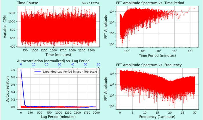

Applying the FFT to the CPM data gives this picture:
The upper and lower right graphs show a pronounced dip at a time period of 3 sec (frequency 1/3 Hz); lower left shows an auto-correlation lag (blue line) also of up to 3 sec. There should not be anything 3 seconds in any of these graphs! Instead there should be a structure as shown and explained in the GeigerLog manual, pages 35-36 https://sourceforge.net/projects/geigerlog/files/GeigerLog-Manual-v1.0.pdf/download
The GMC 500+ Date&Time is too fast by now 59 sec over almost 2 days. That is a lot! The timer seems broken. I am still wondering about any causal relationship between these observations?

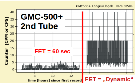

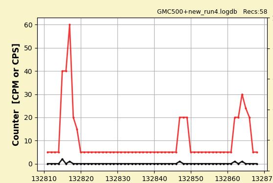

Looking at the counts of the 2nd tube (the low sensitivity tube) gives further insight into this messed-up situation:
in Black is CPS, in Red is CPM. CPM is steady at a minimum of 5, while it should drop down to zero. When CPS registers one single count, the CPM should increase by 1, but it increases by 20! And this count increase should last for 60 sec in the CPM track, but instead it drops back to zero (actually to 5) already in the next second. And that is not even consistent, as it sometimes drops by 5, sometimes by 6.

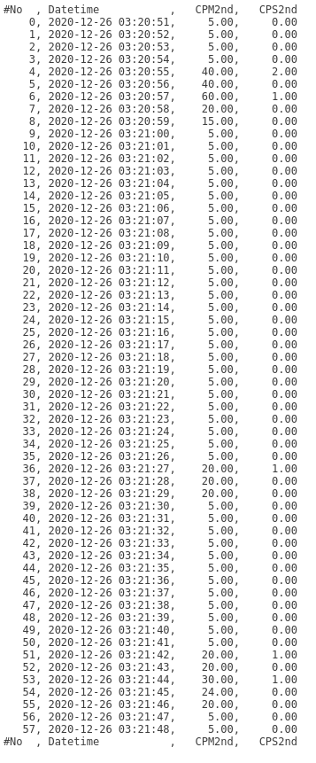

Here the tabular data for easy inspection:
This is wrong in so may ways, I am speechless.

Okkkkkkkkkk
you are right, I did not know precisely the laws of Mr. Poisson, which applies perfectly and be reference to the 100% random events contrary to the normal law.
and if I apply Standard Deviation = Square root of average with normal distribution algorithm, I find consistent results with your poisson curve.
Sorry for my mistake. it's stupid it's elementary.
Edited by - Damien68 on 12/26/2020 09:05:13

All response is in your tabular data of 2nd tube.
Looking your tabular data of 2nd tube, it is clearly seen that the CPS is true and it must match the CPS realy measured on the tube.
on the other hand, in this datas, the CPM is clearly an estimate build by a algorithm, which I think explains everything.
for tube 1 we must have exactly the same type of filtering.
On the FFT, the pronounced dip at 3 seconds would correspond has an internal convolution made by the algorithm, we can see this convolution/integration effect (over 3 seconds) on your tube2 CPM raw data. each primary CPS detection have an effect on 3 consecutives CPM value. (your FFT algo is very good).
That would also explain the excess on the variance on the CPM datas for many reasons and we can't consider these CPM data as uncorrelated data because they are correlated.
to have the real CPMs, they must be available in the flash memory of the GMC and only 1 per minutes not 60 (if you set recording to CPM not to CPS). or you can also sum CPS by pack of 60.
the CPM values you use are intended to be displayed on the screen or to be used as is but not in this way
But it's not clear to me to want to do statistics on CPMs that we receive every second.
Blue auto-correlation lag comes from the same convolution (is logic).
PS: filter looks like as a mobile average over 3 seconds but it can be more complex, and it's not necessarily linear (there can be several estimation modes and triggers).
on CPM2nd data,
the 5CPM offset can be a long term integration part:
to make a compromise between reactivity and stability, maybe the response dynamic is split into two parts,
a quick part based on the last 3 seconds
+ a longer term part.
knowing that the whole can be reconstructed on the actuation of a trigger

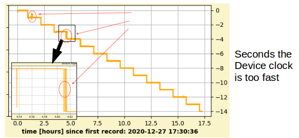

Posted - 12/28/2020 :  02:15:42  Show Profile  Reply with Quote
I am confused by the GMC500+ clock being off by some 20 sec per day. This is huge!
It is easy to record the time difference between the GMC counter time and the real time: in the geigerlog.cfg configuration file simply activate the variable X for GMC devices. You then get the time difference computer-time minus device-time in seconds under the variable X in the log record.
The computer time has a resolution of 1 microsecond, and is kept synchronized with an NTP time server.
I did the recording and here is the result:
There is a continuous and consistent diversion of device time from real time. (The steps have to be 1 sec, as this is the best resolution of the GMC counter clock). On top of this, every now and then the device time flips back and forth inconsistently, see inset.
What on earth was done in the electronics and/or the firmware to create a clock as bad as this one?
Just for some reference: I am using an ESP32 microprocessor, and its clock deviation is measured in MILLISECONDS per YEAR!

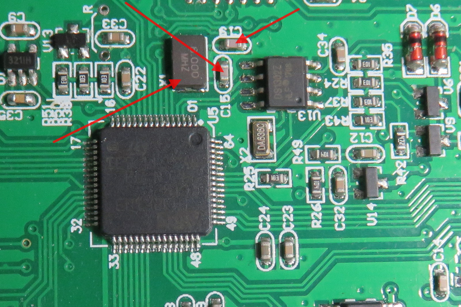

can you check the presence of C15, C19 and X1?
C15 and C19 are the load adjustment capacitance for quartz
a deviation of 1 milliseconds per year represents a drift of 3.18 x 10E-11
On ESP32 (wifi device) standard Quartz to meet Wifi specifications must be around 10 ppm precision

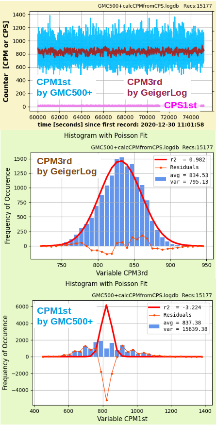

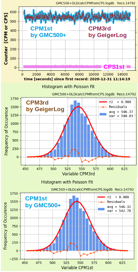

So far it looks like this GMC500+ counter is producing the CPS values correctly, but the CPM values are completely messed up. I looked into that in more depth.

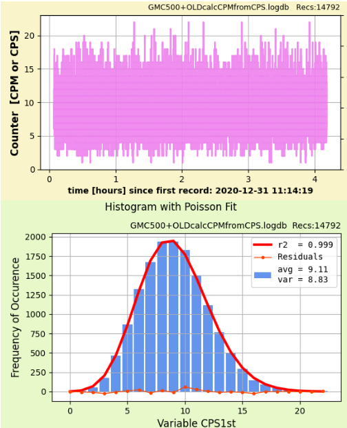

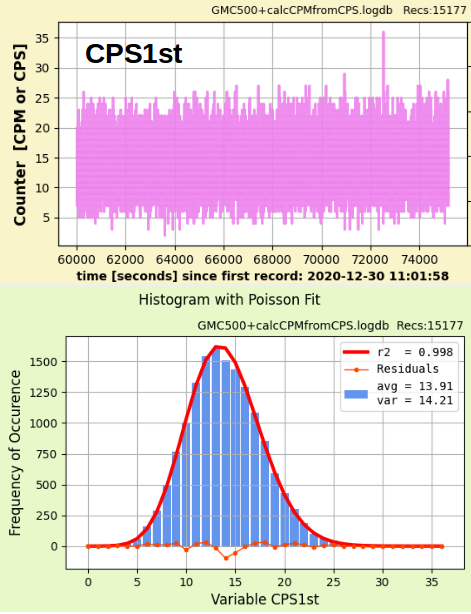

I am using the CPS signal from the first, the high-sensitivity tube, in GeigerLog recorded as CPM1st. This typically had been a M4011 tube, but it seems there is a different one in this GMC500+ counter: I read the label as M01-22, though it is a bit difficult to decipher without opening the case.
The CPS recording and its Poisson histogram are shown in the next picture.
It is not perfect, but very reasonable. These CPS data look ok to me.
The CPM data are nothing but the sum of the last 60 seconds of CPS data, and this is easy to program. So I customized GeigerLog to take the CPS1st counts and create CPM values recorded as variable CPM3rd. (This is not in the current 1.0 release of GeigerLog, but if anyone is interested, I'll leave it in for the next release.)
The next pic shows the CPS1st data as the bottom trace in magenta, the CPM1st data - the ones created by the firmware of the GMC500+ counter - in light-blue, and the CPM3rd data - the ones calculated by GeigerLog from the CPS1st data - in dark.brown.
It doesn't need sophisticated math to see that there is a huge difference between the two CPM traces, but I am showing the Poisson histograms for the two traces anyway. The counter's CPM1st data are not even close to a Poisson distribution!
Without any doubt, the GMC500+ counter is producing nonsense CPM values. And my guess is, any counter using firmware 2.24 (and other?) will be producing the same nonsense.
How can one possibly mess up the calculation of the sum of 60 values, whatever the computer or the programming language?

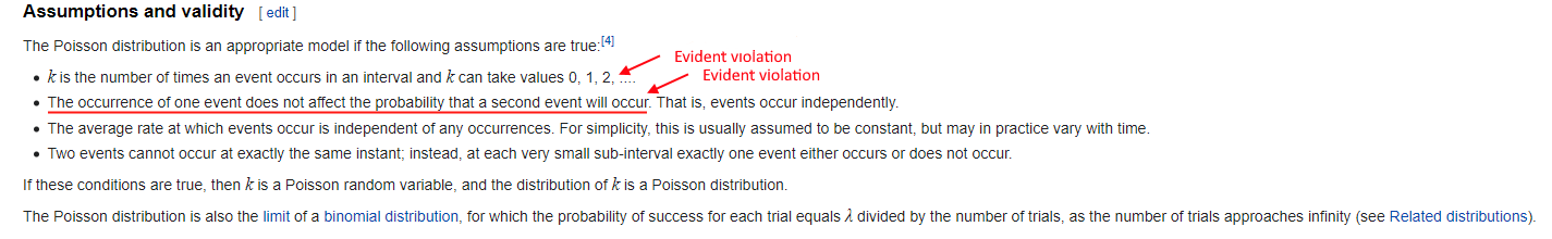

It's clear that the counter CPMs have nothing to do with CPMs. counter CPM must be pulses count during last 3 second multiplied by 20 or something like that. and for that is not pure discret values (1,2,3,4,...) but typicaly much more (20, 40, 60,...) + offset (long term integration) and ratio factor adjustement to normalise the output to be consistent with CPMs.
in addition counter CPM is an autocorrelated signal because 1 pulse have inpacte at least on 3 consecutives CPM values.
So for at least 2 reasons the counter CPM don't meet poisson assumptions.
see 'Assumptions and validity'
https://en.wikipedia.org/wiki/Poisson_distribution

1255 Posts
Posted - 12/31/2020 :  07:44:28  Show Profile  Reply with Quote
So counter CPM don't meet poisson requirement.
I'm sorry, but this is nonsense. I really recommend some studying of a primer on poisson; you should know by now where to find it.
It does not matter whether you do CPS, CPM, Counts-per-Hour, Counts-per-Month, or Counts-per-17.834 seconds - they will ALL be poissonian! What you MUST NOT do is change the time-interval during recording (what the GammaScout counters like to do) and you MUST NOT multiply any values of any of the counts-per-time-interval by any number different from exactly 1.
Think about it: a background CPS with average 0.3 results in an average CPM= 0.3 * 60 = 18. But the record of CPS might consist of 0, 1, 2, and perhaps 3. Multiply these with 60 and you get 0, 60, 120, 180 for the CPM record. So, what happened to the numbers from 0 to 180 missing in this list? They are absent, and will never exist. Such an outcome happening by statistical chance is as likely as the famous herd of monkeys writing Shakespeare! Such a multiplied list is clearly non-poissonian.
It gets even worse when you multiply with non-natural numbers - like a calibration factor. Then you get a list of numbers with decimals, and thus they will never be poissonian, as Poisson is valid solely for natural numbers (plus the zero), and invalid for everything else!
To demonstrate that both a counter and GeigerLog can deliver proper results, I repeated the last experiment in the same setup and analysis, but this time using an old GMC500+ counter with firmware 1.22.
Using the CPS data from variable CPS1st gives a record of text-book quality:
Then looking at the CPM data, either CPM1st created by the counter, or CPM3rd calculated by GeigerLog from the CPS1st data, gives this outcome:
Now the GeigerLog trace (in brown) is exactly on top of the counter trace (in light blue). In order to make both visible I made the blue line much wider and the brown line much thinner to (kind of) show that the brown line is running inside the blue line.
And look at the Poisson histograms: even the distortions in the columns and curves show up identically in both graphs!
This old counter is the one reviewed here: http://www.gqelectronicsllc.com/forum/topic.asp?TOPIC_ID=5369 We had shown that it has a couple of problems. But inability to calculate CPM was NOT a problem at any time.

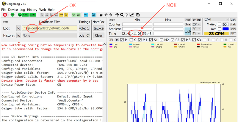

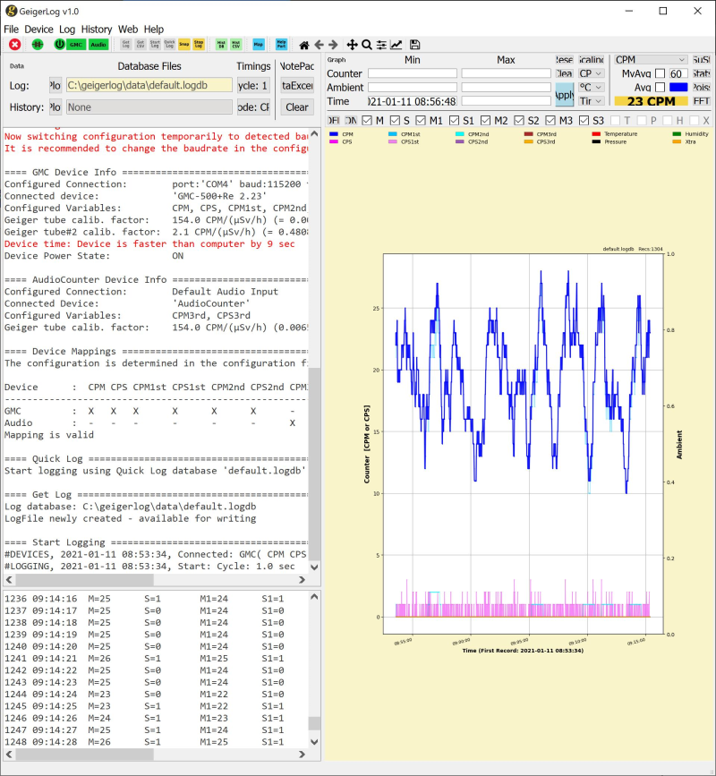

So, I had bought a 320Plus but experienced a display problem with that unit so, after a discussion with Tech Support, it was returned and I now have a 500Plus, which is rather lovely. :-)
After a bit of a faff, I have managed to get GeigerLog working (small problem with button label sizes, see attached image...) and I shall collect some background data to have a play around with the analysis stats that GeigerLog can generate; it looks great too!
One question I have is whether anyone has (a) sorted out the strange treatment of the count values for the two tubes (adding them seems odd) and (b) has anyone replaced one of the tubes with an alpha-capable tube at all?
Tra!
Piggly
Apologies for the HUGE size of the original image...now reduced I hope!
Edited by - WigglePig on 01/11/2021 01:50:56

Good Lord, you call this " a small problem"? I have never seen such before, I think this is horrible. I guess it is something about available fonts on your system. Would you mind helping me in figuring this out? Then, please, start GeigerLog with this command:
geigerlog -dvwR
and publish or send me (e.g. via Sourceforge) the resulting file 'geigerlog.stdlog'.
Re your data: do not forget to set the counter's "Fast Estimate Time" to 60 seconds, or you will get nonsense CPM* data!
The summing of the counts from the 1st and 2nd tube and presenting as CPM and CPS data is a different kind of nonsense, which has been discussed broadly already 2 years ago: http://www.gqelectronicsllc.com/forum/topic.asp?TOPIC_ID=5369
Much was found out back then, enjoy the reading!
Replacing the tube(s) with a different one is possible. I have used - among a few more others - a SBT11A (alpha sensitive) on a GMC300E+ and a 500+. You must observe some things, or render your data useless: use very short leads (<30cm) from your counter to the new tube. If you can't do that, understand the issue of capacitance of the leads, and the need to relocate the anode resistor to physically very close to the new tube.
More discussion here: http://www.gqelectronicsllc.com/forum/topic.asp?TOPIC_ID=4598
(And don't forget to set the anode voltage appropriately). Good luck!

@WigglePig, what is your screen size in pixel?
the problem can be a conflict if for example the size of the controls are defined in pixels and the size of the fonts in millimeters.
Edited by - Damien68 on 01/11/2021 02:56:43
Reply #31
WigglePig
31 Posts
Posted - 01/11/2021 :  03:04:43  Show Profile  Reply with Quote
3840*2160 but you have just made me think about something...I use the display scaling set to 200% because at the native resolution any text is too small to read. I would imagine this is where the issue comes from.
Reply #32
1255 Posts
Posted - 01/11/2021 :  04:43:20  Show Profile  Reply with Quote
@WigglePig: I looked at your log, and can't find anything wrong (as an aside, consider adapting the geigerlog.cfg to your situation - do you presently use audio? set the USB-serial ports).
Chances are, your scaling creates the problem. Obvious question: what happens if you reset it to 100% (or whatever the OFF-setting).
Python's PyQt5 has provisions for scaling, but they still have side effects. But the fact that your other software becomes too small to read suggests that all this other software also cannot handle a hires screen adequately!
There is one thing that is easy to try, though I doubt it helps: start GeigerLog in a different style. You have styles 'windowsvista', 'Windows', 'Fusion' on your system, with the 1st one currently active. Try the other two with (capitalization important!):
geigerlog -dvwR -s Windows
geigerlog -dvwR -s Fusion
Otherwise, can you start GeigerLog in a batch-file which first switches off scaling, and then starts GL, and on exit of GL switches scaling on again?
I can switch scaling on and off when running GeigerLog but this leads to the issue again of not being able to read the text on anything on the desktop or in apps. At present I have a work-around which works whilst I am at my workbench, in that I use and external second display with lower resolution so if I display Geigerlog on there then I can read everything. The issue with the built-in laptop remains though.

I ran the GMC-500+ overnight, and here I show only the output of the counter for the 2nd, the low-sensitivity tube.
Again, these are values as they are produced by the counter firmware and read by the computer. They are NOT calculated by GeigerLog.
The left half is with a "Fast Estimate Time" (FET) setting of 60 seconds - meaning that FET is switched off - and the right half with FET set to the magic "Dynamic" setting.
Does anyone still claim that the two settings give identical results?
Reply #36
Posted - 01/15/2021 :  04:55:58  Show Profile  Reply with Quote
I wish could say it's the same, but I have dificulty.
F*CK! it looks like a bug
where is the good, certainly the left? or what is the radiation exposition level?
20CPM for tube 2 it would be wise to leave
and there is still a floor at 5CPM crossed but present in fact it does not seem to be at all a dynamic floor but a DIY, it's too bad.
Edited by - Damien68 on 01/15/2021 05:59:38
Having considered a little more about where this "base value" of 5 comes from, I believe it is likely to be a rounding error in the calculation of the CPM using the FET approach...I wonder if using different FET times might lead to different rounding errors and therefore a different "base value?" In this case, with a FET longer than 3 seconds we would likely see a REDUCED "base value" if this were the case.
Can I ask why you are using the 2nd tube to illustrate this? Is it because, with lower CPS values you would expect to see wild swings in the estimated CPM whereas the 1st tube with it's higher sensitivity and higher background counts will mask some of this?

this enriches the histogram by providing additional relevant "crossed" data.
if each events was registered many time, each start and stop time was differents and give a different representation, it's like looking at same thing from several angles.
it's not necessarily stupid and it is sure that we will add informations.
Edited by - Damien68 on 01/15/2021 08:51:16
we can not really know where the 5 comes from but what is huge is the normal level of the output which is ~15 CPM in Dynamic mode and ~2.5-3 CPM in 60 seconds mode
Edited by - Damien68 on 01/15/2021 08:28:26
Gosh, how many times have I already shown the distortions of data coming from 1st tube readings? And people still argue that it's kinda, sorta, still ok. No, it isn't.
Now I show a truly gross example from the 2nd tube.
The source is basically my collection of Th gas mantle and some U minerals; just to get high counts.
Reply #43
Posted - 01/15/2021 :  09:11:00  Show Profile  Reply with Quote
@ullix, as they say in French, I played devil's advocate, but your last data convinced me. I don't know what can be demanded for this devices, but what is certain is that the enormity of the last measures should be easily avoided.
