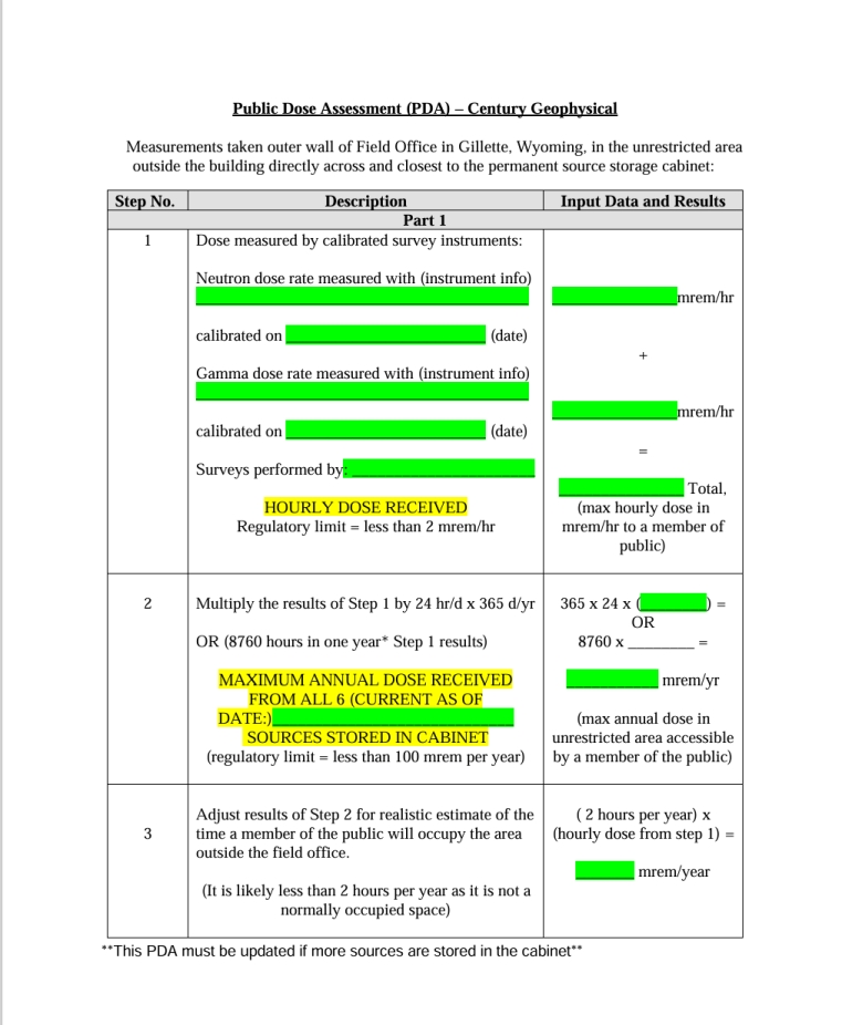

GTS,
Here is an example Public Dose Assessment form that the NRC gave me to determine what the outside of one of our field offices was. I think it goes along with what you are saying.

Hi Tony81269,
Good find.
According to the NRC:
1) The 2mR/hr limit is a check that should be included.
2) Background should be excluded. It's very small if you use the GQ GMCMap app which has it at about 0.12 uSv/hr or 0.012 mR/hr average near SONGS.
Other things to consider:
1) No Neutron radiation reading was taken. I wonder what it could be at the RR cars.
2) Then there is the question of uncalibrated/uncompensated GMC machines. Using a uncompensated GM counter, especially a very small one, to quantify an accurate radiation measurement is not recommended. Readings using these small tubed GM detectors tends to overestimate the readings. Instead of something like 1.5 mR/hr the more accurate reading could be something like 1/2 of that.
3) Your company and Edison say it's safe according to federal guidelines. I assume they can back this up with data and calculations which would be nice to see. Are they willing to show you that info, which would include things like the "Public Dose Assessment (PDA)" form from above?
