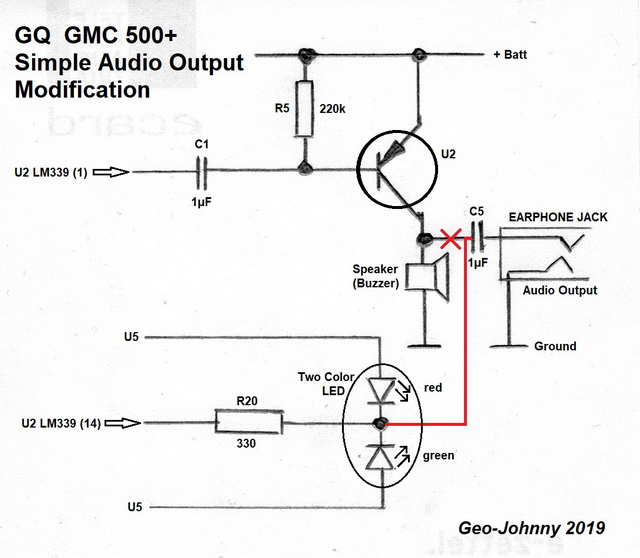

If interested, I can open a separate thread showing the layout change with photos and a partial schematic of the change. There is also a screenshot of the Count Impulse from the Android app. If someone can solder SMD, the change takes five minutes. All you need is 5mm thin wire.

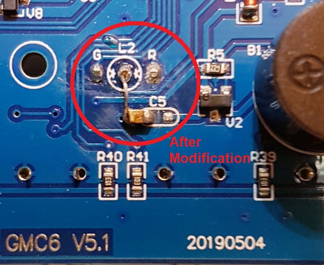

Posted - 07/21/2019 :  02:54:59  Show Profile  Reply with Quote
Yes you can make a separate thread for this one.
No, i think the modification is so simple that no need a own thread.

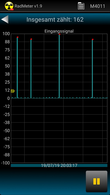

And, pictures say more than 1000 words.
Screenshot from the Android App "RadMeter Pro" (soft inverted Input!)

Posted - 07/22/2019 :  10:02:31  Show Profile  Reply with Quote
Good work!
Thank you for sharing. This part should be improved from GQ.

Posted - 07/22/2019 :  12:19:29  Show Profile  Reply with Quote
Originally posted by ZLM
Good work!
Thank you for the flowers. It's certainly not a professional solution, but it works very well for my needs. The GMC 500+ is brand new, I did not want to destroy anything and i was looking for the simplest solution. Sure, there are better solutions with triggered output, etc., but for me it's enough. Previously, you could not even press a button, because it was immediately triggered several false impulses, a horror, that got on my nerves.

Posted - 07/22/2019 :  13:35:28  Show Profile  Reply with Quote
Thank you for sharing this. I see GQ has upgraded the PCB board to version 5.1 and it is now GMC6 as 'model number'. The part you modified is same for the 4.1 PCB board. I don't want to steal this thread, but would like to know what changes went into 5.1 from 4.1? I notice just below the (+) on the M4011 tube in first picture above a white rectangle that is folded over the PS transistors. Is the board just simplified or other capability added? Thanks!

@EmfDev
What does your engineer say about my unprofessional amateur modification?

2320 Posts
Posted - 07/23/2019 :  13:50:50  Show Profile  Reply with Quote
It's good as long as it works! Although I can't figure out how it worked. Haha. The middle pin is ground.
Geo-Johnny
Austria
161 Posts
Posted - 07/23/2019 :  14:13:14  Show Profile  Reply with Quote
That is not completely right. The middle pin of the LED is negative but not ground !!! Before that is R20 with 330 ohms and that's the trick. The plus signal comes via the (two) LED's to the middle pin (cathode). At the moment of the impulse, this point is positive (high), because the internal resistance of the diodes is much smaller than the 330 ohms. Can you follow me?
Geiger Counters: GMC320+V5 & GMC500+
Geiger Tubes: M4011; SI-3BG; SBT-9; LND712; SBM-20
2320 Posts
Posted - 07/23/2019 :  14:35:02  Show Profile  Reply with Quote
Ohh I see, thanks for explaining. So it still works even if you turn off LED in the options?

Posted - 07/23/2019 :  22:33:37  Show Profile  Reply with Quote
Yes, I am surprised, but it also works when the LED is turned off. I have a guess, but I did not have time to measure it. When I have time, I will find out why it is.

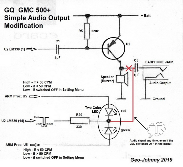

Listen, my english ist not the best. So i try it with a corrected picture.
I hope now it is not so hard to understand?
Reply #24
2320 Posts
Posted - 07/25/2019 :  09:46:45  Show Profile  Reply with Quote
Alright thank you so much! Looks correct. There's supposed to be an orange color when CPM is in Medium range from 50-100 where both LEDs are High but it just becomes red.

161 Posts
Posted - 07/25/2019 :  09:50:38  Show Profile  Reply with Quote
Incidentally, when I look at my drawing, I think of a cosmetic firmware option. From 51 to 99 CPM, the CPU could set both anodes of the LED to High Signal. Then the LED would light orange at medium level. Because green and red together make an orange light.
It's just an idea of mine, but a cosmetic top idea, because programming would be very easy.

Posted - 07/25/2019 :  10:38:17  Show Profile  Reply with Quote
That is coded that way. Both terminals are set to 'High' already when CPM is in medium default is 51-100? But The Red dominates that's why we just see red instead of orange.

So what happens when a click comes through to the LEDs when this modification has been made? Do they both blink or ??????????????

Posted - 07/25/2019 :  11:49:47  Show Profile  Reply with Quote
Okay, then we can nothing do. It is not importent, it is just cosmetic. Important is the change from green to red, thats enough.
Wich modification you mean? If you mean my solution with the audio output, this has no influence on the LED.

Yes, I was asking about your modification. So the LED doesn't react at all to the pulses from the audio circuit.

Posted - 07/25/2019 :  21:08:06  Show Profile  Reply with Quote
No, the LED only responds to the counts as intended. But my modification brings a clean audio signal at all times, even if the LED or speaker is turned off by the user in the settings. The GMC 500+ audio output works perfectly now.

Hi,
when the two anodes of the LEDs (red + green) are high, it is normal for the led to remain flashing red, because the red diode has a lower voltage than the green diode and therefore takes all the current that passes through R20. In order for the LED to light up in orange, it would have been necessary to place two resistors (one for the red anode and another one for the green one).

Posted - 08/25/2019 :  01:10:13  Show Profile  Reply with Quote
That's right, but just to make the diode shine orange, the layout change and the effort with two resistors is too big. The GMC320+V5 was then solved with two resistors,by the GMC500+ is just one resistor.

Posted - 08/25/2019 :  03:07:07  Show Profile  Reply with Quote
yes it's correct, for my part, I do not find the necessary of orange light. it's just to understand.

Posted - 06/26/2024 :  04:47:10  Show Profile  Reply with Quote

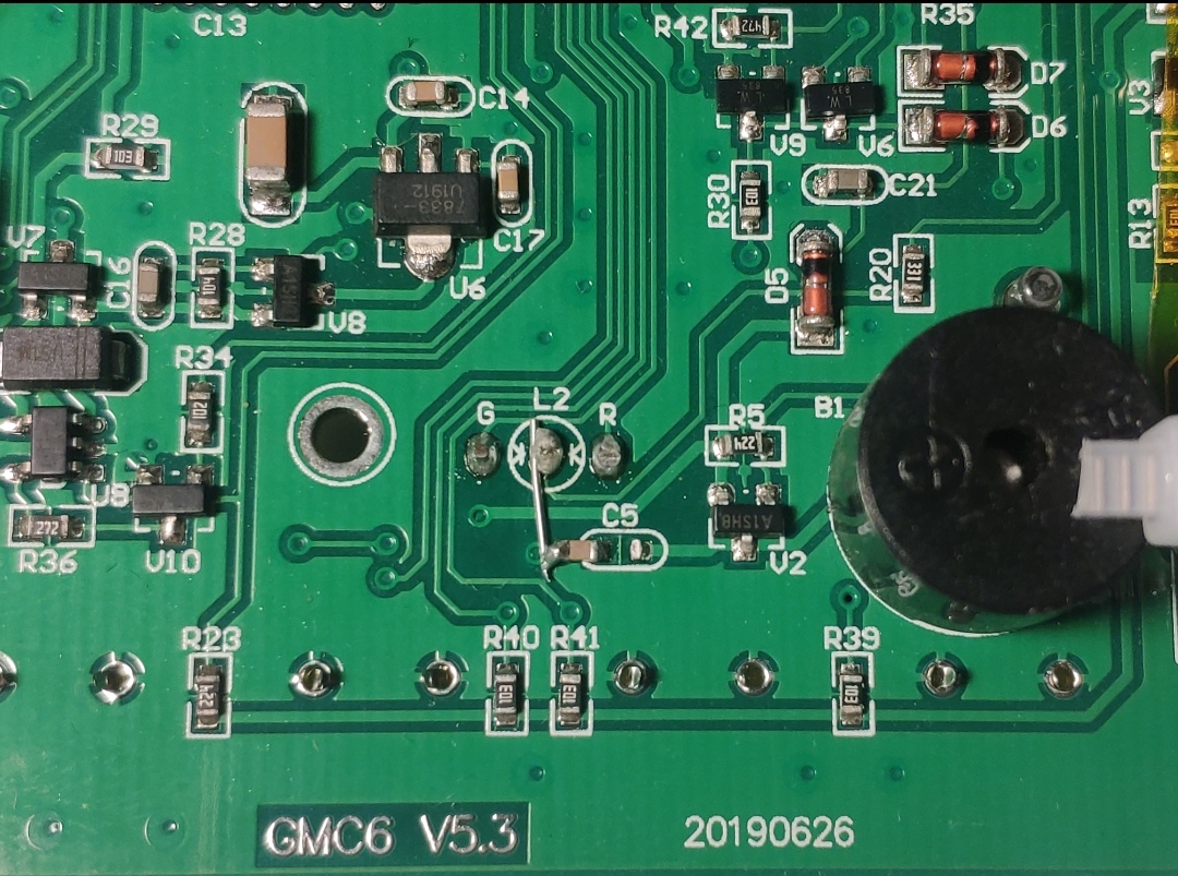

My board version is 5.3. Is this modification to the board necessary or has the board been modified? I don’t quite understand why the 3.5 mm jack is needed, can I connect headphones if I make a modification?
Update:
I tried this modification. This works weird. The LED is always on, and when receiving a pulse from the tube, a faint flicker is visible. When you bring the source close, the LED lights up very brightly. Headphones can work with the speaker turned off, but the sound clarity is worse, and with a large number of impulses, a continuous sound appears. My firmware is 2.53G, board version 5.3. I removed the modification and it works as before, there is sound in the headphones, as long as the speakers are not turned off. Third party port settings do not change anything.
Update 2:
It works, but you can't use headphones. What does it give? You can turn off the speaker, but the 3.5 output will work. Without modification, there is interference when you hold the device or press buttons and a lot of measurement errors and signal transmission to the application on the computer. If you turn off the LED, the number of pulses will be reduced by half.
