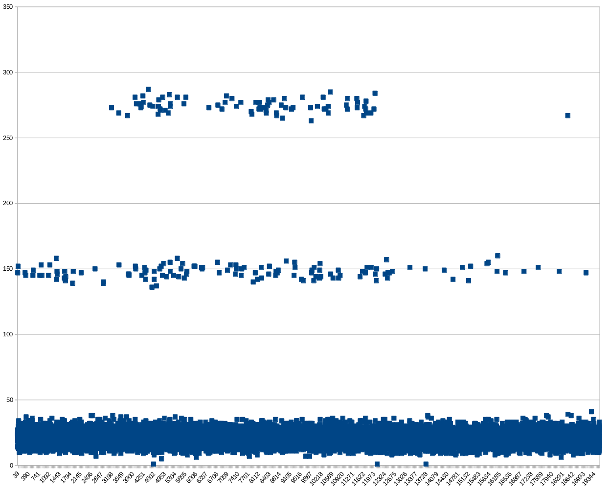

This graph of CPM, most recent to oldest, gives a feel for what I'm asking about.

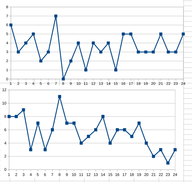

Here's the hour of the day frequency for the two bands, the higher CPM on top and the middle CPM below. I think they're random.

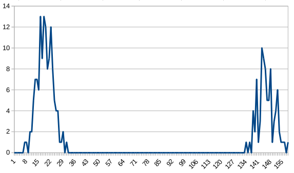

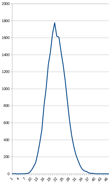

A couple more plots, the top is CPM distribution in the range 0-50 and the bottom is the CPM distribution for the two narrow bands - please add 130 to the x-axis values to get the actual CPM. I think all three distributions are all normal though I'm puzzled by the notch at the top of the first plot.

The other detail is that two time periods make up the data. Looking at the first graph, everything to the left of reading 12060 is from the last fifty days. Everything to the right is from September 2016, and while the two sides are different they both show the two narrow high-count bands. I hadn't intended to include the 2016 data but it's interesting that the effect has lasted across the whole 16 months.
The "I'm puzzled by the notch at the top of the first plot" might be related. It's evident that the data shows (at least) two periods differentiated by an average two CPM. Whether that's a result of a shift in the background radiation, or a shift in some other environmental factor which has affected the meter, isn't evident. I'm sure I relocated the meter from a drawer to the tabletop during the intervening period covering the measurements. That could easily be responsible, and seems far more likely than a change in background radiation.

Interesting and puzzling result. These spikes surely do not come from anything real. Likewise those from the other chap you linked to. They are always single offs in a sea of normal background values.
My guess is, it is a software issue, perhaps in the recording software.
Your background is 22, add 128 (=2^7) and you get 150, add 256 (=2^8) and you get 278. These would be single bit flips. The agreement with your data is unlikely just by coincidence.
